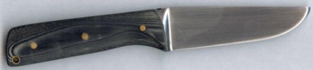

Here's a hunter I just finished a few days ago, still needs sharpened, and won't get a sheath till someone buys it and tells me what they want.
Specs:
7.5" OAL with a 3.5" blade of 1/8" 440C, Black linen micarta scales (gettin bored with theses, gotta go buy more wood) and brass pins and thong hole. Tried to put a little nicer finish on this blade, its a little cloudy around the plunge, but I'm gettin better at it.
Don't know if it will show up in the pics but this one has a pretty nice swell to the handle, pretty comfy grip.

I've come to really like the way you file your name into the edge of the tang. I didn't care for your early attempts, but it looks much better now.
That is a good looking utility/hunter. I really like the way the blade blends into the guard. Gives the knife a classy look.
Thanks alot :)
I'm glad the logo/makers mark is gaining favor. If nothing else it has a nice surprise factor to it. It usually gets the biggest reaction when I show someone a knife for the first time.
Glad you like the blade to handle transition too. I've always felt like a true gaurd gets in the way on a small knife like this designed for amore utility type role, but its important to have something between your fingers and the blade ;)
I like it. It has a clean design, something that I always look for in a knife. Why don't you try forging and making the same knife with carbon steel blade and temper line ? Should give you more variation to your product line. Not critics, only suggestion. Beside I'm a big sucker for a carbon steel knife. :D
