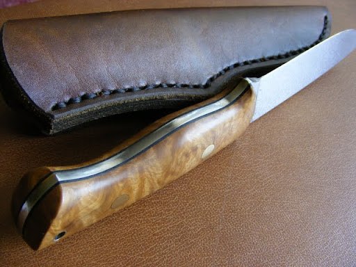

Hunting knife, RWL34 steel, Brown malee burl handle.
Jan 19, 2007
288
http://www.youtube.com/watch?v=3J13H_2IQLo
Hunting knife, RWL34 steel, Brown malee burl handle slabs with leather spacers, brass bolts and tube and leather sheath.
Gallery
Yep, I use thin leather instead of fiber. Before I mount the slabs I glue the leather with epoxy to the slabs and trim the excess. I soak the edges of the leather with cyanoacrylate before finishing the handle, so it can't expand from water and moist.
Very nice. I like the idea of the leather spacers. Have you ever had problems with expansion, despite using the cyanoacrylate?
