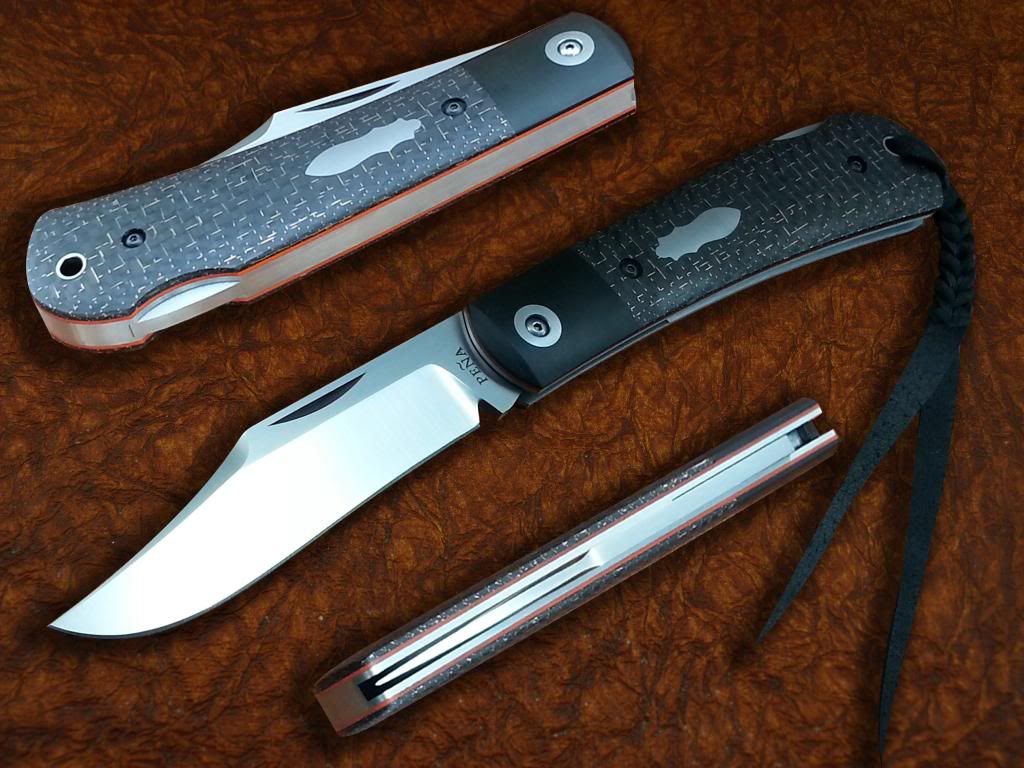

Hello to all. Here is something that I have been wanting to make for a while. It is what I would call a hybrid. A cross between a semi traditional pattern with modern materials modern technics for assembly and is 4 1/8" closed. I would like to here your opinions on this knife as to whether you like it or not and why. I'm looking for constructive criticism. Thanks in advance for your comments in advanced.

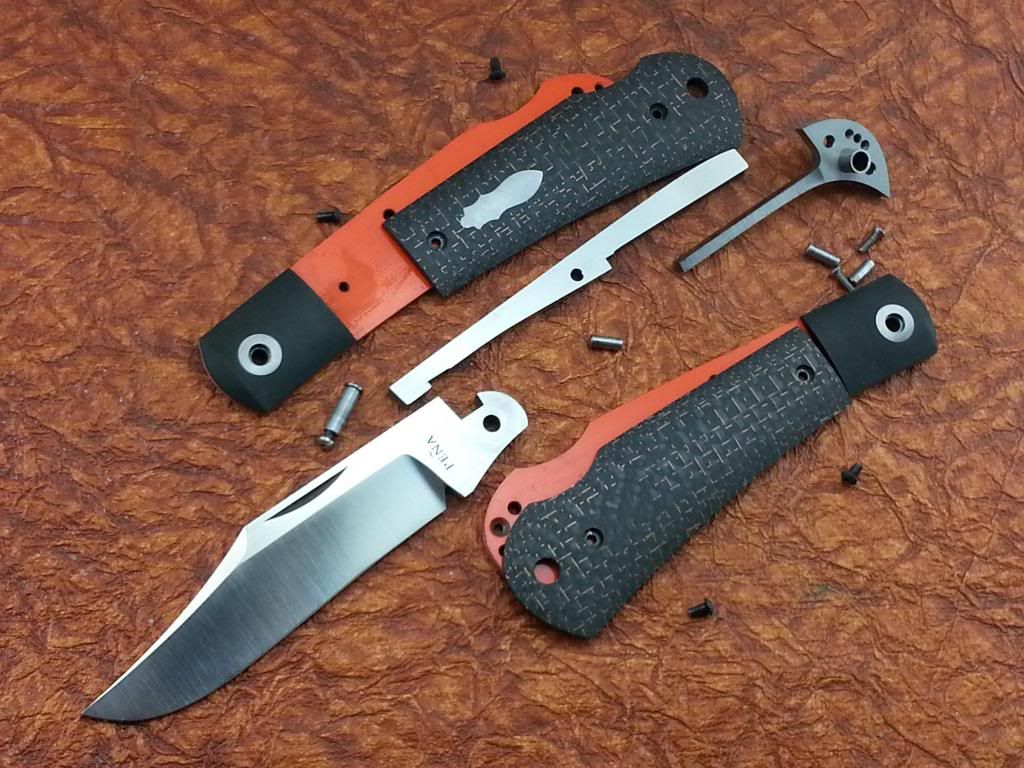

Very nice VERY clean work too. The pic of the knife all disassembled is great.

Looks very nice. I like the contrast in material colors, however red, green or blue would trip my trigger more than orange. The blade shape and swedge are sweet. A person can also tell you know how to grind a nice thin edge, without some of the irregularities that others have. Good hands :)
Per suggestions, it is not clear how thin this knife is, but it looks thick. At 4.5" I'd still want to put it in the pocket, keep it's profile thin. Beefy only means strong to those who don't understand. I would also suggest using the mid-lock and not an end-lock configuration. As a lock back ages (15 years or more) it can wear and need less movement to open. In this case, sometimes in a tight grip, the last two fingers of the hand can release the lock. Many of the production companies went to mid-locks, not sure why custom makers don't as well.
I think you pretty much nailed it.
Only suggestion I have, is making a point of using and promoting the use of those super steels for a knife like this. Not a big deal, but there does seem to be a portion of the market that has to have the newest in steel alloys, and whose buying habits are dictated as much by that as by anything else.
Old meets new with spectacular results here. I bet you really enjoyed making this one. :thumbup::thumbup:::thumbup:
Your knife images are always so clear and vibrant.
I reckon my opinion is worth what you paid for it, but...I really, really like it!
I absolutely love the design, the look, and the feel.
My only quibble would be that the blade would seem to work better to my eyes if it was a shade thinner.

1st I am ignorant in regards to the folder construction so my opinion may not be realistic.
But....exposed screw heads bother me and in my opinion detract from the overall beauty of the knife.
