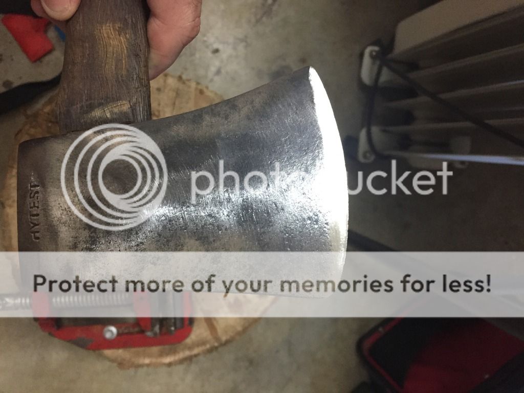

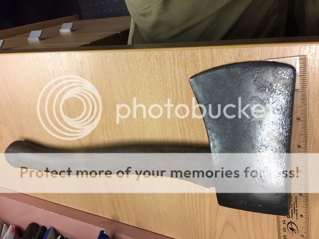

Just had this arrive :thumbup:

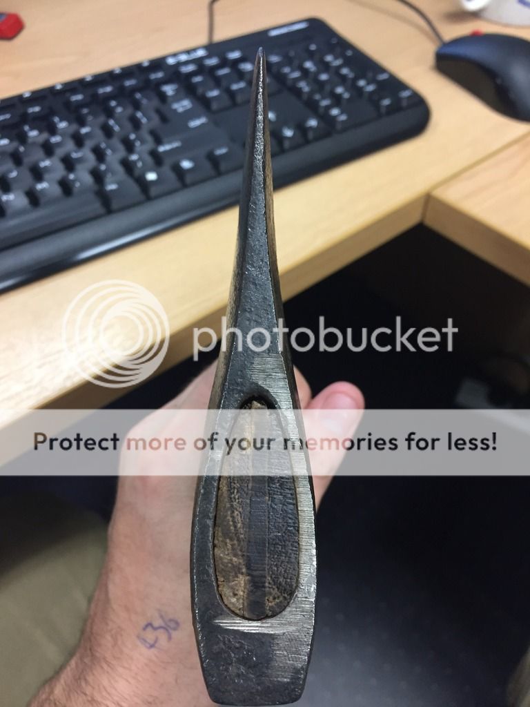

Its a Hytest Hatchet, which as far as a I can tell are quite rare.
What I think is awesome about this (other than being a hytest which is cool in itself) is that's its a real axe shaped hatchet complete with beveled cheeks etc.
At just over 5 inches long this IMO, is one bad ass hatchet complete with features often only found on real / quality full size axes. Many hatchets are just simple wedges/small ASO's. (which generally work fine for a hatchet)
Behold :cool:
The handle is a bit loose and the head does not sit quite straight. I havent decided what im going to do with the handle as yet if ill try to salvage it or rehang it on a fresh handle...will probably go the new handle route but we will see what it looks like when I take the head off and see what I have to work with.

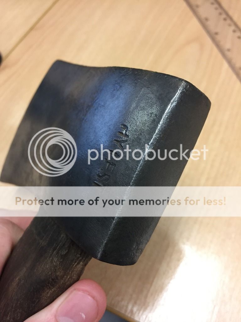

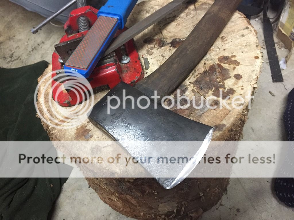

I put an edge on it last night. Its got some very hard steel. Took some elbow grease to sharpen. I also tested the poll and im pretty sure its hardened. I hammered some random small bits of metal into a log and also tested it with a file. The file test was a little inconclusive though as I really didn't want to go scraping up the poll. Really a good file will cut it if its hardened or not..scratching the patina off and not damaging the steel was enough for me :)

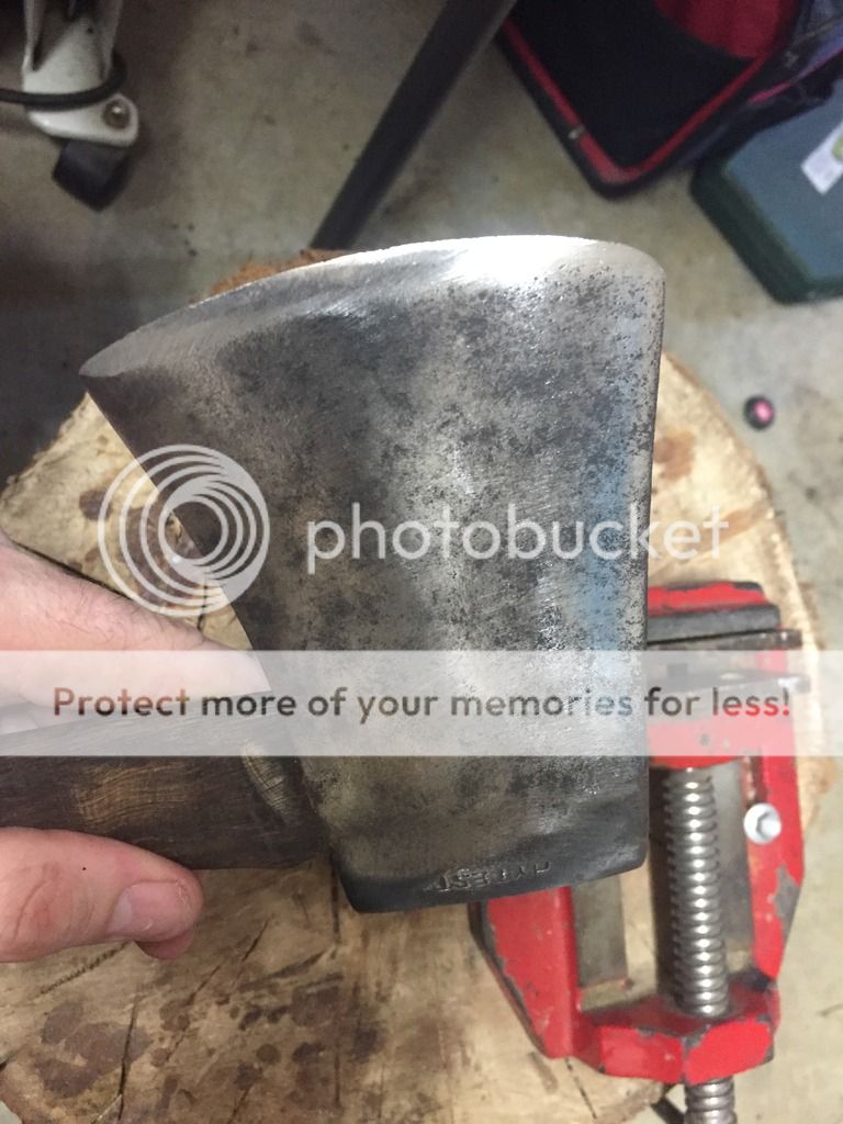

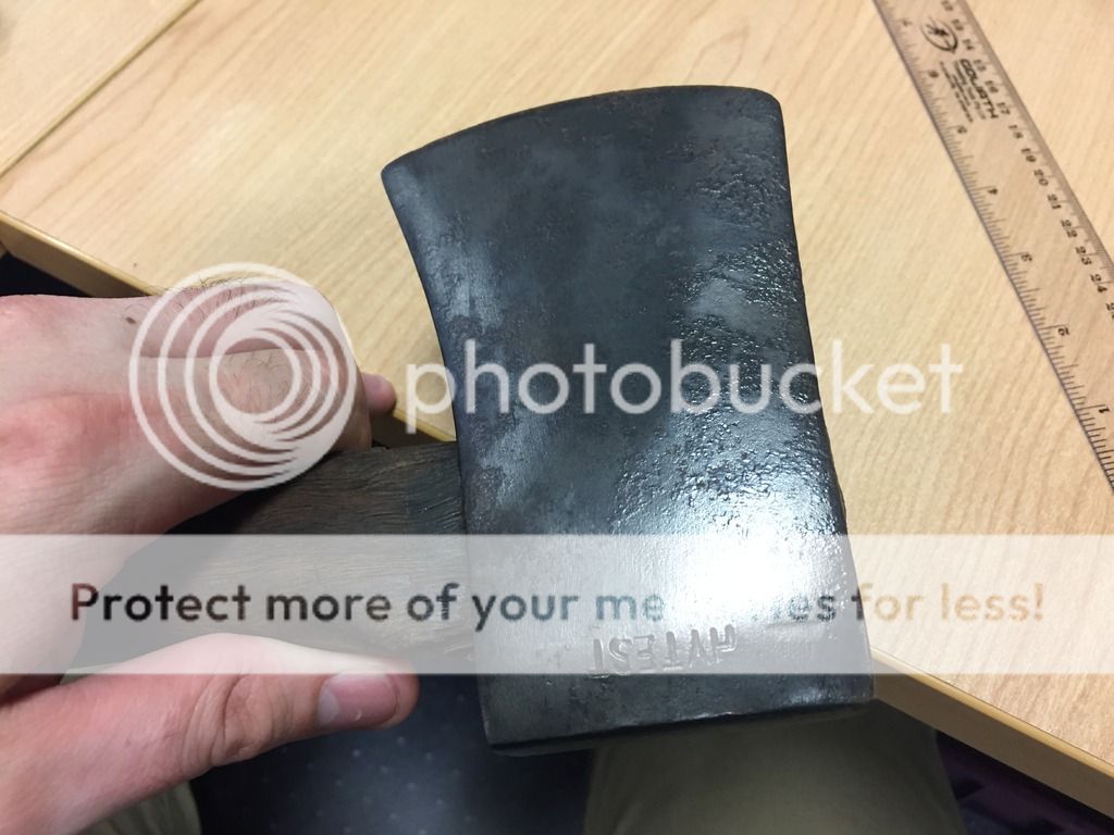

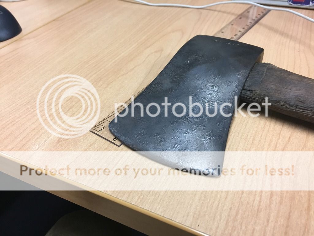

I have a question. See on the ax head how some of it is not smooth? Like its got either pitting or forging slag on it. What do you guys think that is?
Im in two minds about weather to try to sand it off or not. I think it maybe forging slag, in which case I dont want to remove it.
Firstly because its raised from the rest of the material, and not depressed (pitted). And secondly when I tried to scratch it off with a very hard blade (cpm10v 64hrc) it didnt really scratch off like rust would. Its obviously had some bluing or something applied, but underneath the rough bits appears to be steel, and not rust.
What do you guys think? To leave the rough bits or not? Forging slag or rust? I don't want to start sanding it to find its solid steel (slag) and not rust.
thanks!
It's rust slag. And the bluing is rust bluing. I generally recommend staying with a brass wire cup brush when cleaning up old axes because the brass preserves more of the patina. But when I have stubborn rust slag like that I'll switch it the knotted steel wire cup brush. Just concentrate on the bumps and stay away from the rest of the surface as much as possible.
Interesting use of a drill press vise on the stump. I bet it makes for a sturdy vise.
Thanks for the tip. Ill pick up some wire brushes and see how I get on :)
Good spotting re the drill press vice haha. It does indeed work well and is very replaceable / you don't need to worry about mucking up the surface. I use it all the time for my axe & knife escapades. I do have a real vice but I generally just use my log. lol

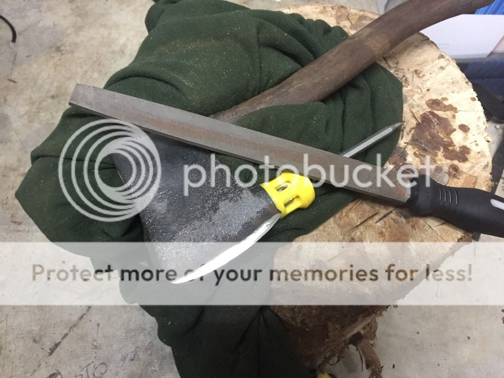

edit. the other good thing about the drill press vice over a normal vice is that its very low profile. What this means for sharpening (axes) is you can clamp an axe handle in it(I would put an old tshirt or something in there so it does not mark the wood), then you can put something underneath the axe head (usually a screwdriver handle) so that you can file as hard as you want and the axe head cant move down with the pressure applied. Obviously not as issue if you want to clamp the haft really tightly. But this way you can get away with clamping soft enough as to not damage the handle, and the axe cant move no matter how hard you push.
ill get a photo of how I do it sometime :)
edit again, looks like I took a photo last night. note haft clamped in vice, with screwdriver handle under axe head so it cant get pushed down or move in the vice. works well

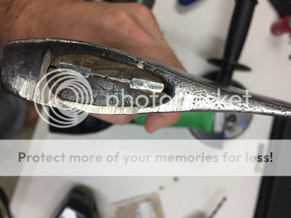

I got some time to hit it with the disc and it did what I wanted, which was to remove the raised rust/slag stuff.
There is still some pitting there but all the raised stuff is gone which is good. I didnt like the idea that what whatever was under the bluing may continue to corrode.
I also decided on sticking with the original haft and so banged a steel wedge in to tighten things up. Should hold fine i think.
Will maybe get some bluing solution, or may hit it with some olive brine to darken it again.
