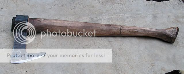

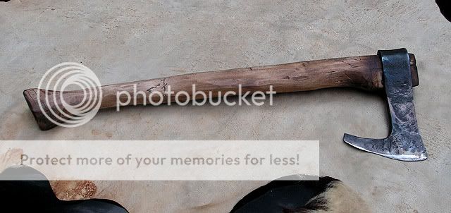

Look Robin, I'm actually putting a 'hawk in the 'hawk and axe forum..
Last week I wanted to throw a hawk and I couldnt find a one here. Didnt realize they had all gone to new owners.
So over the weekend I fired up the Redbud Forge and done four. This is the first sort of finished, still want to do a
little more to the haft and make a cover
It is a wrap around made from a file and the beard is a piece of another real old Nicholson file heat welded in between.
(I dont trust the iron in the newer ones for the cutting edge) All hand and file work.
17″ haft, head is 7″ with 3.5″ sharp. The haft is from a chunk of maple firewood I split a couple of years ago, drawfiled,
oiled, torched and scrapped. I only get a while at night to work on them so Ill show the rest as they come along .Randy
