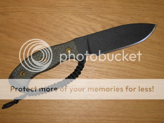

I have just returned from an outing in the woods, and I have now definitely robbed my new NO-E of its virginity. I used it for various camp chores, like limbing, splitting seasoned, knotty pine (this stuff was really hard and tough, not like pine in general), chopping firewood, carving figure four traps, and whittling a spoon. All in all, it saw about 1,5-2 hours of very hard use, mostly chopping. After reading a lot about INFI, I really felt that I needed to know what my knife could do, so I put it through is paces: I hammered away at it, using full force blows with a big stick in order to baton it trough the dry pine, I used the tip for full-force prying, and the back for breaking sticks. The knife suffered no damage at all, and what is even more amazing, the edge was completely undamaged after all this rough treatment. It still felt sharp, though it could no longer shave. There was no visible chipping and no light reflecting in the edge, so rolling was minimal. After looking at it with a magnifying glass, I would say that the loss of sharpness was due to micro-impaction (micro rolling). I restored the edge to a super-shaving sharp in literally five minutes, by touching it a few times with a ceramic whetstone and then stropping.
The knife performed very well for what I was using it for. It chops and limbs great, but is a little too long and wide for fine carving, even with a choked-up grip. The D-guard I added makes the knife feel very secure in the hand while chopping. The back of the handle felt a little abrasive when doing full-force chopping, so I am thinking of sanding it down a bit. The coating held up surprisingly well, it just smoothened in a few places. Amazing stuff. I love this knife!
As a side-note, the dangler kydex/leather sheath I made for the NO-E held up fine and worked just as intended. Sorry, no pictures this time – I didn’t bring my camera.
...some old pics...
