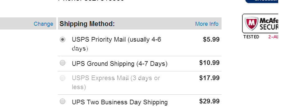

Those guys dropped the ball with me. Ordered the 29th, paid 6 extra for "priority" and it's just gonna arrive tomorrow.
'Priority' shipping is 4-6 days so it's actually on time lol But I know what you mean, we all hate waiting.
Priority shipping is actually 2 day shipping, they tack on 4 days for handling. That is absurd.
I never get my priority mail in 2 days, it's a miracle if I get it in the 3 days. I usually don't waste money on faster shipping anyway, less stressful just being patient.
