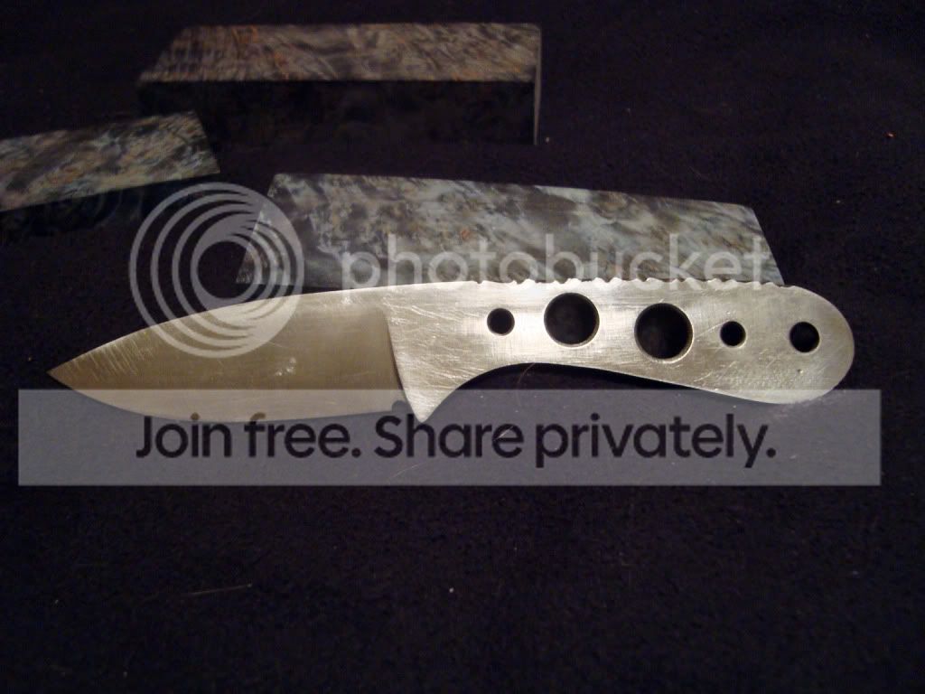

With that I revisited a little EDC design I had come up with and did a home HT on before my surgery. I really liked the original and found it to be a knife that I kept using despite how ugly it looked. It was ugly because I didn't really expect my HT to take so I didn't put much effort into the finish of it, never even put a handle on it or made a sheath for it:o Then just after or just before my surgery johnymac made one almost identical to the one I had done, but his finish was impeccable:thumbup: That inspired me to make another one and give it the attention it deserved. I spent yesterday standing in the cold on my little 30X1 grinder and portable band saw and this is what I have so far.
I even gave my hand a go at some file work
not the best but it is my first try at it. I think maybe 1/8" steel was a bad choice for my first try at file work and that it would have turned out better with something like 3/16" or better. Still I showed it to a friend and it is sold already for my full asking price.
When my elbow started to bother me I stopped sanding, its only at 150 grit right now and i want to get to 400 or 600 before HT, I decided to give the original knife a nice home to honor its inspiration and abusive service:o so I also made my first kydex sheath.
As much as I like making leather sheaths I really like the way the kydex sheath turned out and the new knife is getting a kydex sheath too, along with some natural linen micarta scales, with black liners and epoxy to fill in the file work. As soon as the pre HT sanding is done on the little knife that gives me 3 to send out for HT, giving me something to do while the wind and snow are blowing.

Cool man, Is that handle leather cord wrapped? and is it just tied on or dipped in epoxy?

Its just a quick leather wrap, I crazy glued the top and put some contact cement down the handle to help hold it in place then crazy glued the bottom. It was never meant to last as long as it did, but it keeps on going. I even tried it out as a throwing knife and hit a nail. It chipped the edge right near the tip, I ground it smooth put it on the sharpening stones and its still going. Its an ugly knife with bad geometry, but it some how works for everything I do with it.

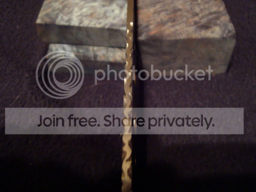

I grew up in eastern Ontario and only moved here about 9 years ago, believe me stay out of the prairies if you don't like the cold, BC, eastern Ontario or western Quebec are the warmest in that order. BC is always wet and expensive though. I have a bit more sanding to do on the damascus blade tonight so its ready to head out tomorrow, you can't see the pattern in it though because I filed and sanded my vinegar etch away already, but its one of Dan Seaver's random patterns. I think that was the one that gave him the last bit of money to buy his surface grinder:D. The blue dye birch burl are going to be the scales on it, with brass pins
