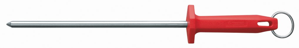

Can anybody put me straight on my very limited knowledge below.
1: So if your knife`s edge is simply worn down, it needs a light grinding to put the edge back on.
2: If you edge is folded over a simple steeling/aligning should fix the problem for a while, or it flakes off, then it`s a grinding.
3: If your edge has a chip in it, the entire edge will need to be ground down till the chip is gone.
4: original butchers steel steels don't grind they just realign a folded edge.
5: Are diamond steels grinders, they remove steel they don't align.
6: Are ceramic steels grinders or aligners or a bit of both.
Thanks.

1: Pretty much correct, assuming 'worn down' means dulled by wear/abrasion.
2: Also correct.
3: 'Chipping', depending on how damaged that actually is, can sometimes be tolerated for a while. It may be corrected over the course of several sharpenings. But yes, usually it's the case that the edge would (eventually) need regrinding to completely fix chipping damage.
4: Butcher's steels DO remove metal, to some extent, on most knives. They're generally relied upon to simply align a rolled edge, which they can also do. But they're hard enough to do some 'grinding' on a relatively small scale. Think of them as a hardened steel file, in terms of how they work.
5: Diamond 'steels' will do a lot more grinding than aligning, as they remove metal very, very easily.
6: Ceramic 'steels' will also remove metal, more so than a simple butcher's steel, but to a lesser degree than a diamond 'steel' would. They'll also be perfectly capable of doing some aligning, but will remove at least a little bit of metal in the process.
One can also use a smooth, polished 'steel' to align an edge. No grooves on it, like the typical butcher's steel. Instead, it's just a smooth, polished & chromed rod, which is more of a pure 'aligner' than a butcher's steel. It may remove microscopic amounts of steel from a knife's edge, but it's an insignificant amount. See the pic below; it's the model I use, a Mundial 10" Round Polished steel:
