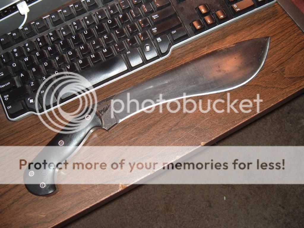

Dont ask! Only this one was made and it's all mine :D I have heard the Machax will be reappearing someday but I wanted one NOW! Still can hardly wait till the actual is available again! I reached into the steel bin and pulled out a 3/8in thick piece of 5160 and started grinding! It's fugly finished as I intend to beat on it so I didnt clean up too many lines on it and I left the mill scale on the blade flats. I used some black G10 for scales and left em a little rough in finsh for a little texture and cause I was lazy with the sandpaper :) I finally got it out to the woods this weekend when the family went out target shooting with friends. We got there early to "reserve" the pit and my Wife was a little chilly so I grabbed the knife and headed towards a brush pile for fuel. Got her a nice warm fire going and a few miles on the blade. It held up fine and I was very happy with it's performance. It is a really great chopper! I did get some very minor edge damage though when I plowed through my old half rotten 2X4 and put the edge into the gravel pretty had but the damage went away with a few file swipes and a touch up on the Sharpmaker. For it's size, I was thinking it might become unwieldly and cause hand fatigue but I didnt have any trouble with it. I took a lot of material off the blade with the full flat/convex grind and I drilled out the tang area a bunch too. it measures 16in overall(straight from point to pommel) and the blade is 11inches long(tip to handle).
Damn, that's nice. About how hard did you temper it, just out of curiosity? Thanks for the story and the photo.
It is about RC57. A little harder than an axe but still easy to sharpen and take abuse :)
So are you ready to take orders? The boss ain't gonna like you stealin his business like this, but darn if that knife ain't just awesome lookin!

mmm, very nice. Machax lines, but the sweet spot is more "pen knife", nearly a WSK there :>
