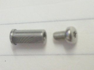

There is Loctite holding the screws together. As far as G10 being hurt by boiling water, that isn't going to happen. Do some reading on what G10is, it's basically chemical resistant and some of the toughest material you can find. It is after all made from woven glass fibers nad various epoxy binders. A soldering iron, hair dryer, or boiling water will help break the loctite and loosen the screws. The pivot on the Para2 is not like your standard bolt and screw. You can't lube the play away, not clean it out or anything else. The pivot bushing, not bolt is designed similar to the way a Sebenza pivot is, tightened all the way down will allow fluid movement of the blade and is supposed to eliminate play (not always the case).
Regular pivot, not my picture:
Para2/Manix2 bushing pivot:
http://www.spyderco.com/forums/show...quot-of-the-Bushing-Pivot&p=822771#post822771
How do I know?
http://www.bladeforums.com/forums/s...oblem-and-a-new-EDC-(?p=10764545#post10764545

If you end up taking it apart, don't forget that the pivot bushing is polarized. One side of the bushing has a notch that lines up with the matching liner.
