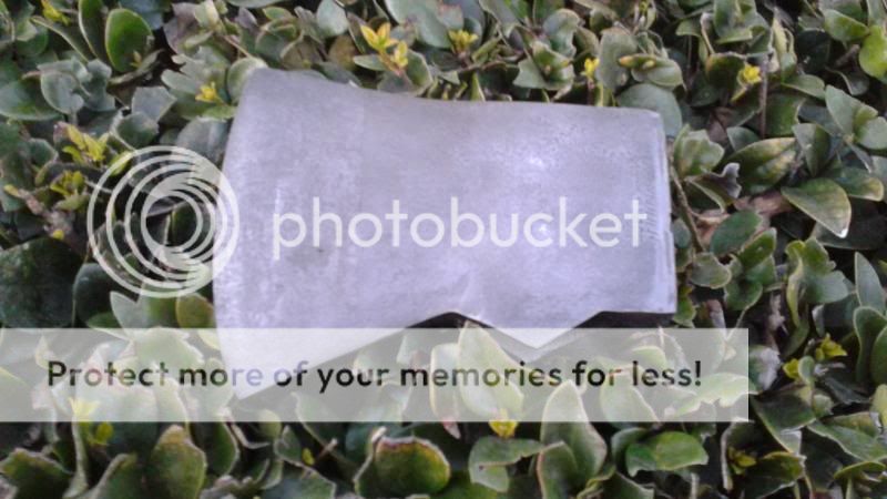

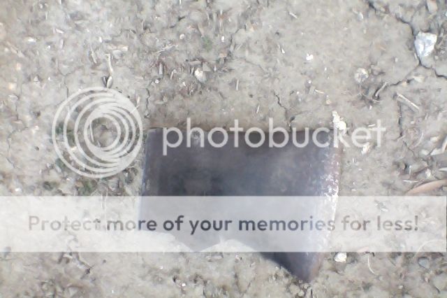

I might've gotten not-the best deal, I bought this off ebay for $46 but I think it was totally worth it
I refurbished it though and it looked like this
My average for an axe head off eBay is around $40-50. You can get heads cheaper at yard sales maybe, but I only get heads that are gonna be premium once they're cleaned, the above head being a good example. If the head has a good or original handle, expect to about double that. We're talking full-sized heads here, like 3 or 3.5 lbs.
