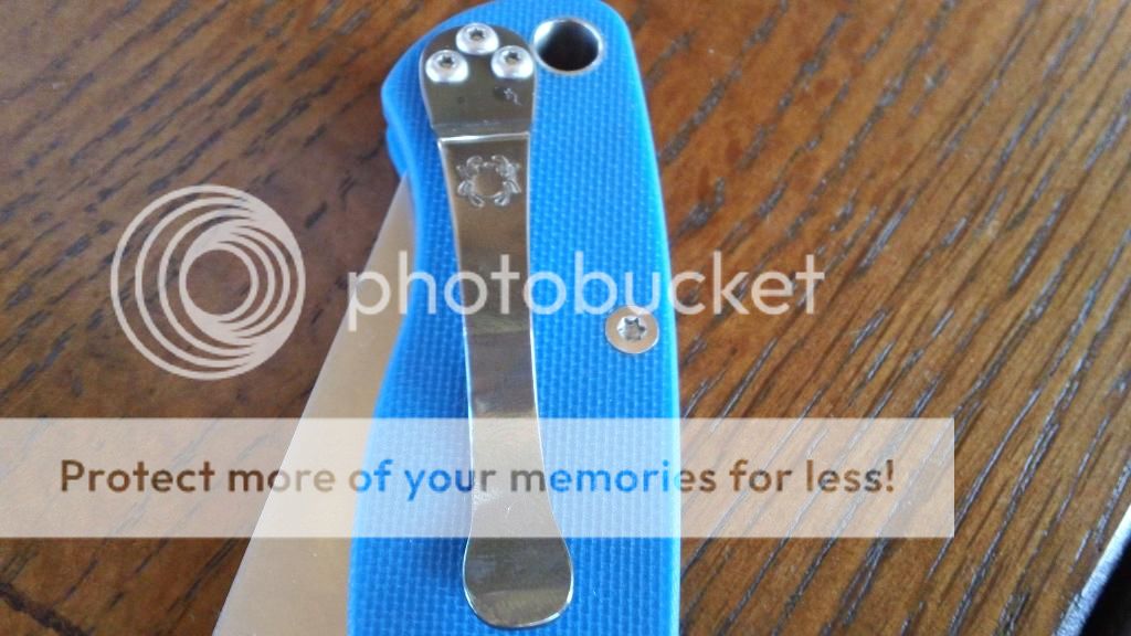

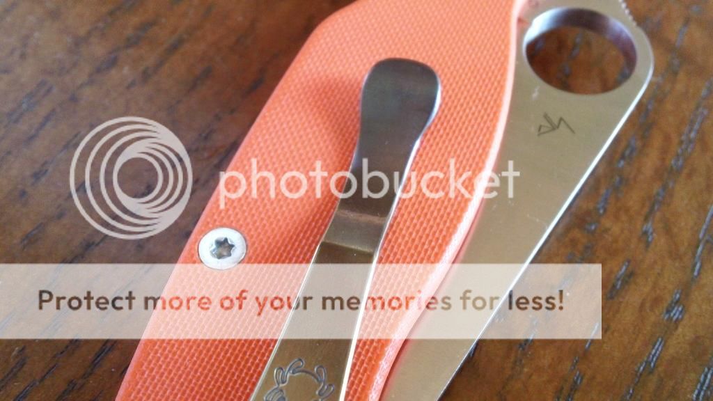

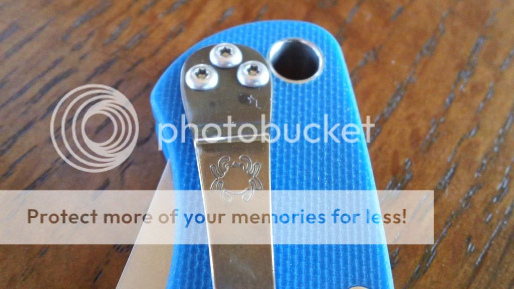

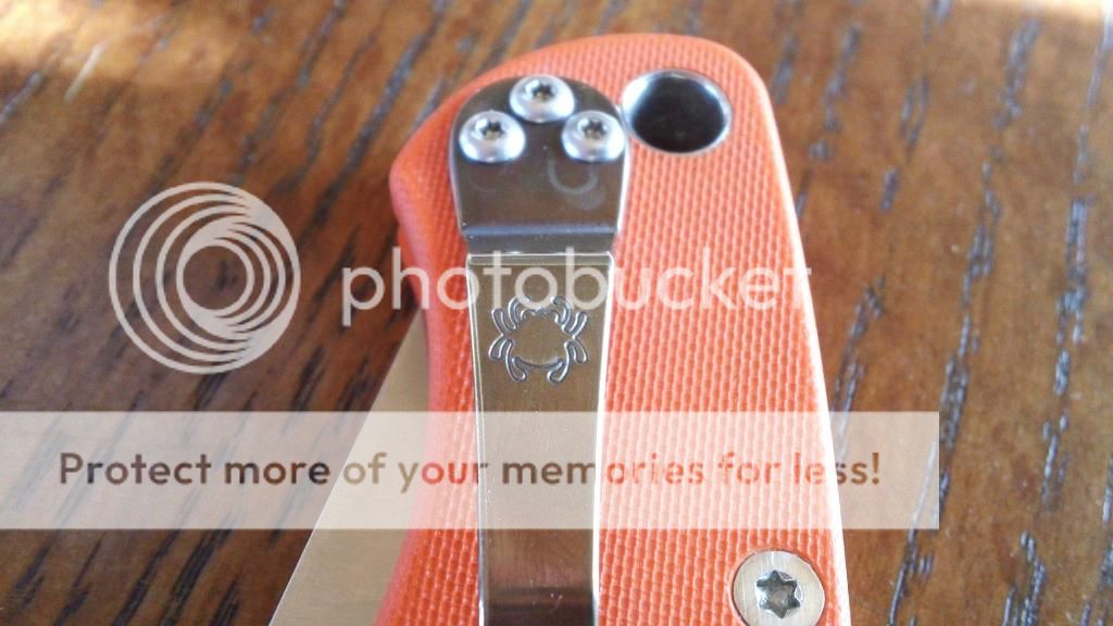

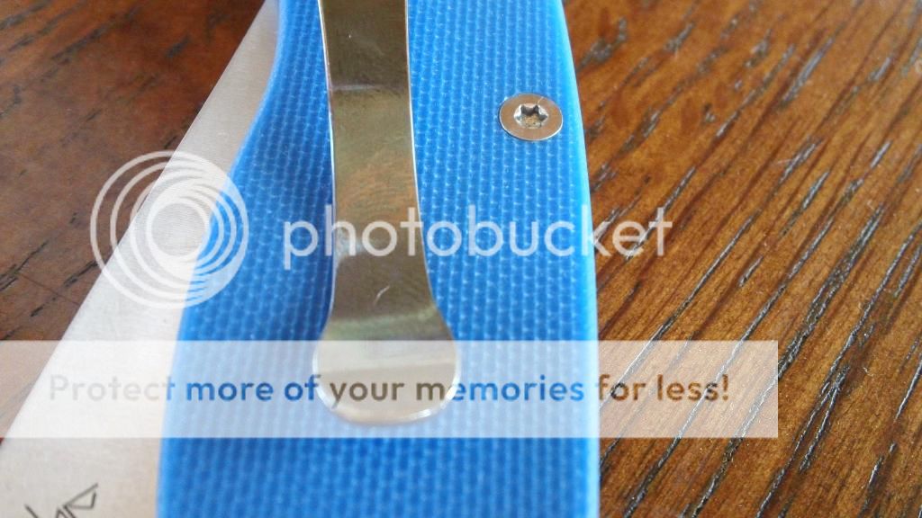

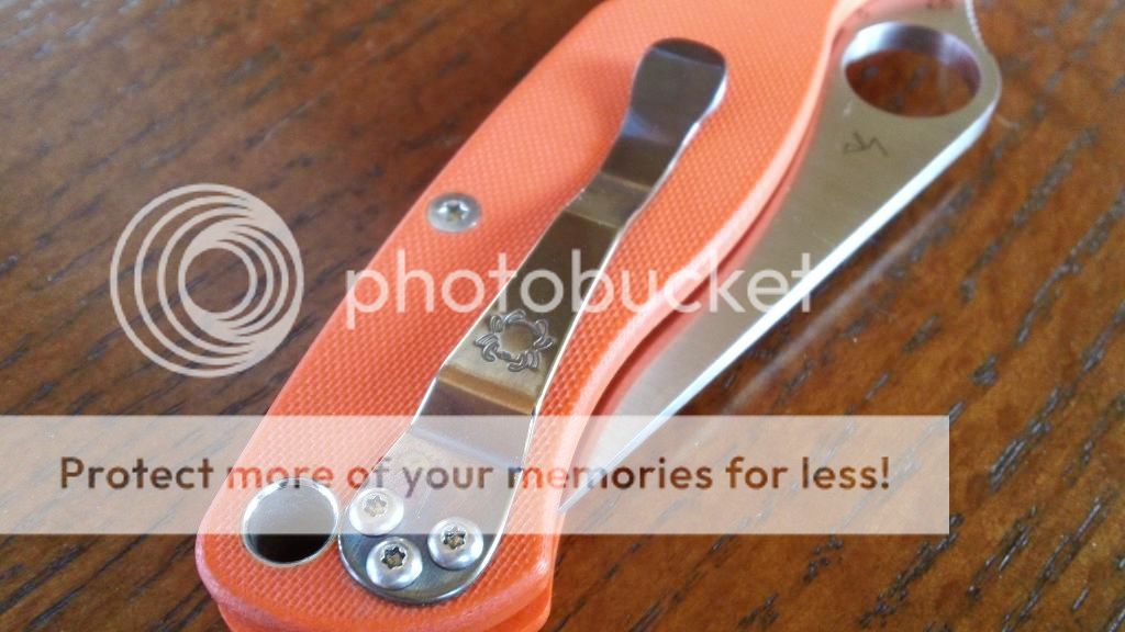

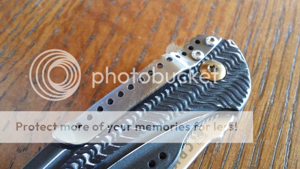

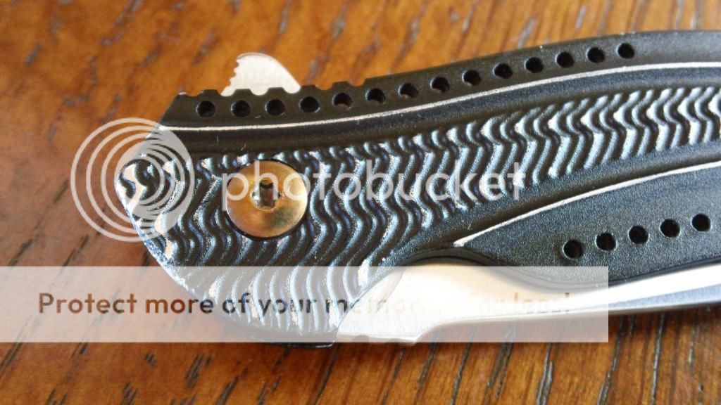

Last night I got inspired to try and do some heat coloring on a few knives hardware. I did two Spyderco pocket clips, and then a CRKT Ripple's pocket clip, pivot screws, and backspacers. The Ripple was my first attempt, the Blue Para 2 was my second. I realized that after those two I was getting finger print marks showing up in the coloring, so I thoroughly washed the last Para 2 clip and went a little slower. I really like how it turned out. It reminds me a bit of the " plumming " that old gun bluing gets. It is not as vibrant as titanium gets, but still cool. I want to experiment with some different finishes now.
At first I was not sure how I got the blues and purples to appear. But after some reading and tips from some others. It appears slow, uniformed heat distribution is key. And the blues and purples come after the bronze/golden hues. So keep slowly evenly heating from the bronze color.
If you go to far it will come out like this.I did quench it in water though so that might make a difference in the color.I have realized that you need to bring whatever you are heat coloring out of the heat and let the air get to it for a minute to see the color.
