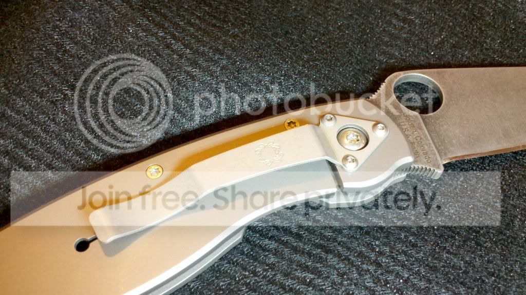

beadblasted.
I've done this for a few years now. I don't think the temper is effected at all. At least they behave in the exact same way and none have ever broke or bent. The color does fade in time as it will wear off and get scratched. When this happens I just polish the clip to get rid of the scratches and redo the color. I also use a propane torch and not the stove, but any heat source will work.
