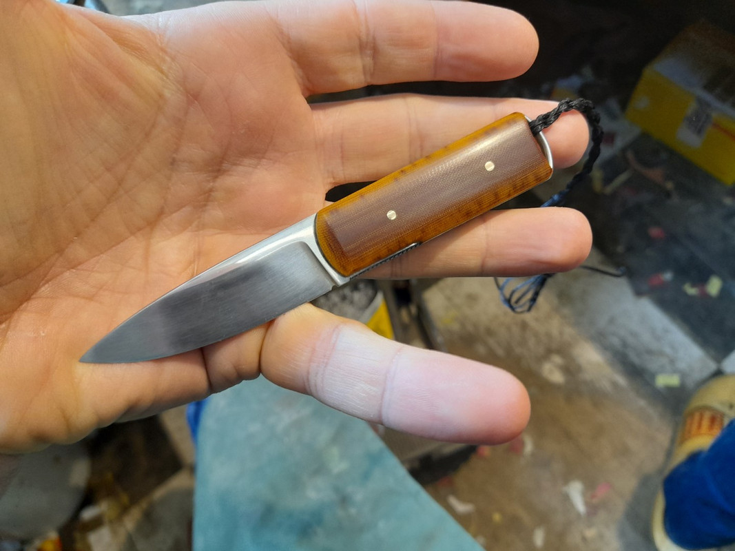

use all the fancy steel you like and outsource HT
Stock removal is no way less then forging, it's just different ways to atcheve the same.
I also enjoy making smaller knives and they are not easier then large knives, there'se less room to compensate small mistakes, less place to hide.
