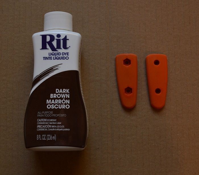

I used Rit to dye some orange BK14 handles. I wanted some practice before trying to dye some handles for the big Beckers and I dont really like the orange handles.
My plan was to dye them brown. The only brown I found locally was dark brown.
They ended up black. Darker black than the black ones from Kabar. I took them out and checked them every 15 minutes for a while but I could still see orange in the middle,on top between the 2 bolt holes. It took about 3 hours before I could no longer see orange. By then they were black but I still like them better than orange.

BEFORE

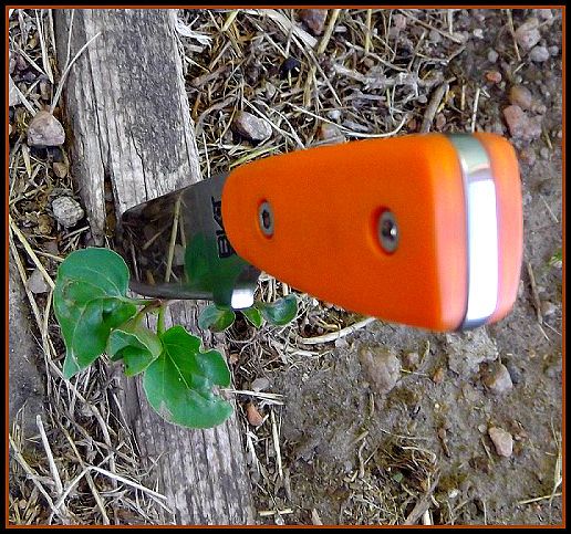

The only orange handles I have left are on the BK14 I miniaturized.

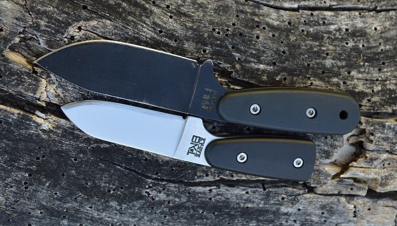

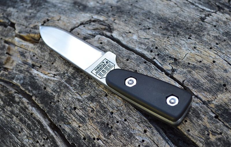

After
I cant get photobucket to stop flipping my last picture over. I tried to re upload it, i tried going into edit and flipping it over. Its the right way until I hit the save button. I even tried to trick it and save it upside down...Nope it kept it upside down. HAHA oh well I give up.

Thanks warrior. Glad you like them. You can see in that last pic they are a little darker black than the other ones.
