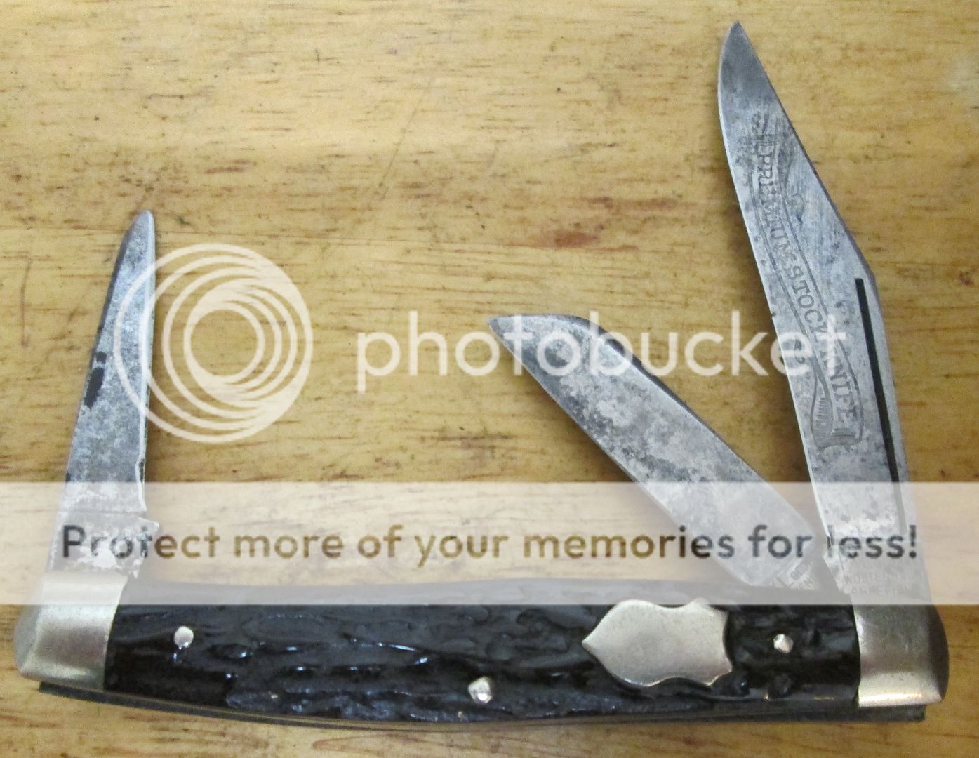

Very surprised was I, when at the local gun show last month I spied an IXL Wostenholm in a display case. Something spoke to me, so I asked to pick it up! Split spring Whittler! Clip main- expected. Spey- nice! Flip it over- PUNCH!!! A clip blade Punch Whittler!! Yes!! Very excited- IXL holds a special place in my heart after being gifted one as a teenager- it's even hard for me to turn down a busted rusted model. Thus knife is firing on all cylinders now!!
I opened and closed it- walk and talk are pretty good! Stiff clip blade, be careful but not rough opening, just solid. Secondary blades opened nicely. No real rust, no gouges out of the blades
But..... Something was off. This Wostenholm wasn't like the others I have or have held. I bought it regardless, because I don't remember seeing a punch whittler, even in pictures.

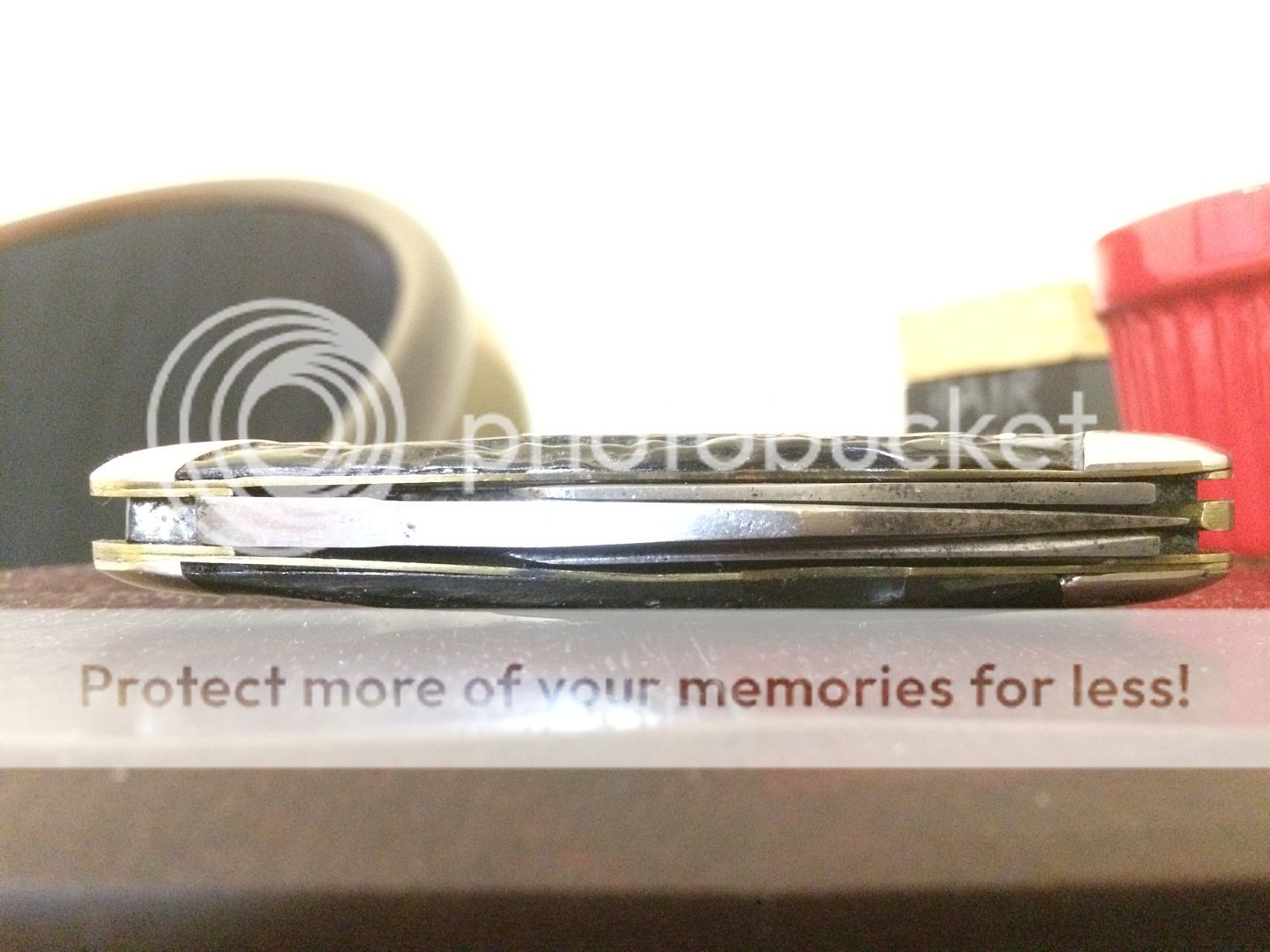

Took it home and looked some more- then it hit me! The one set of scales are bowed!!
One side:

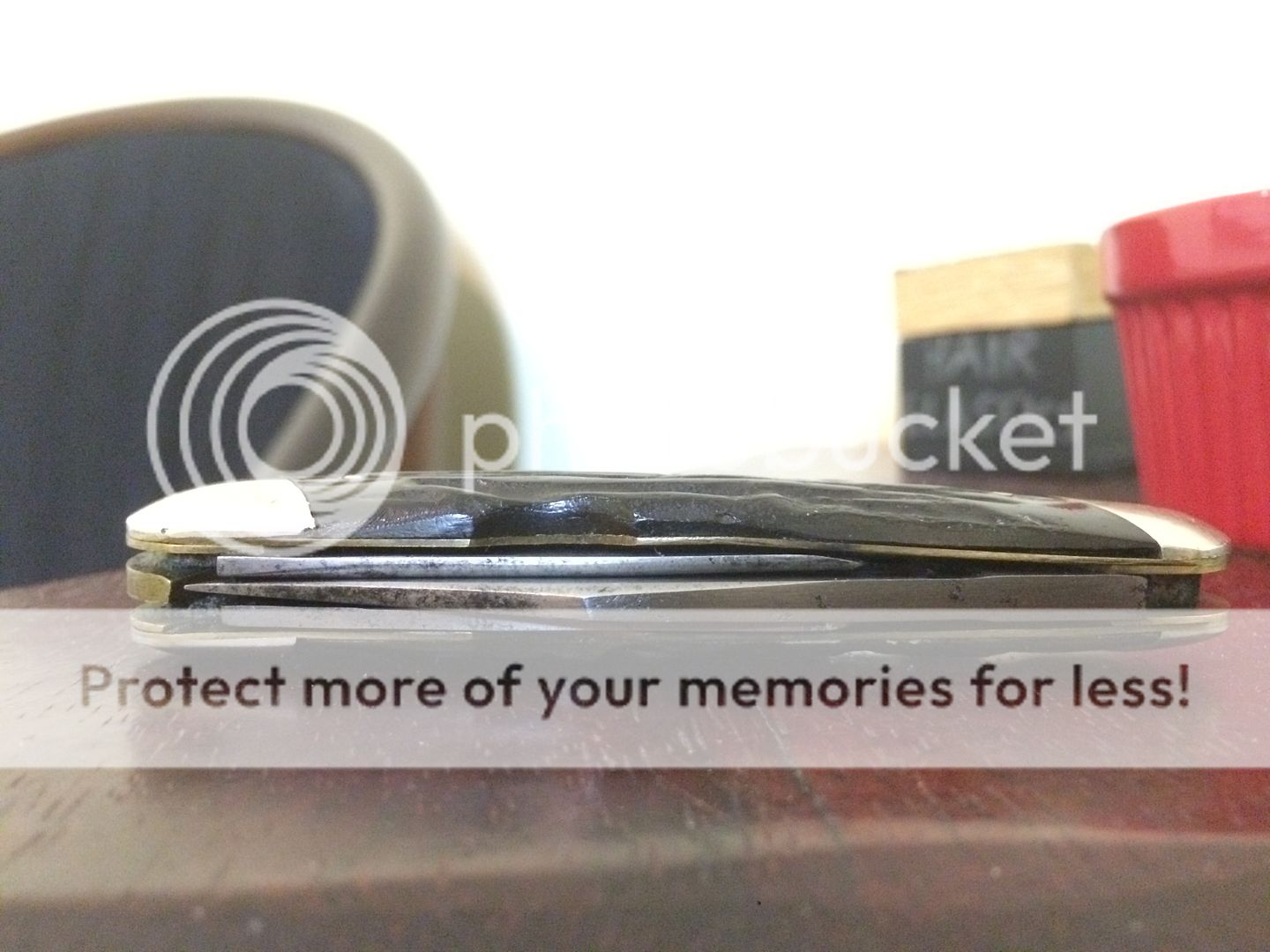

Other:

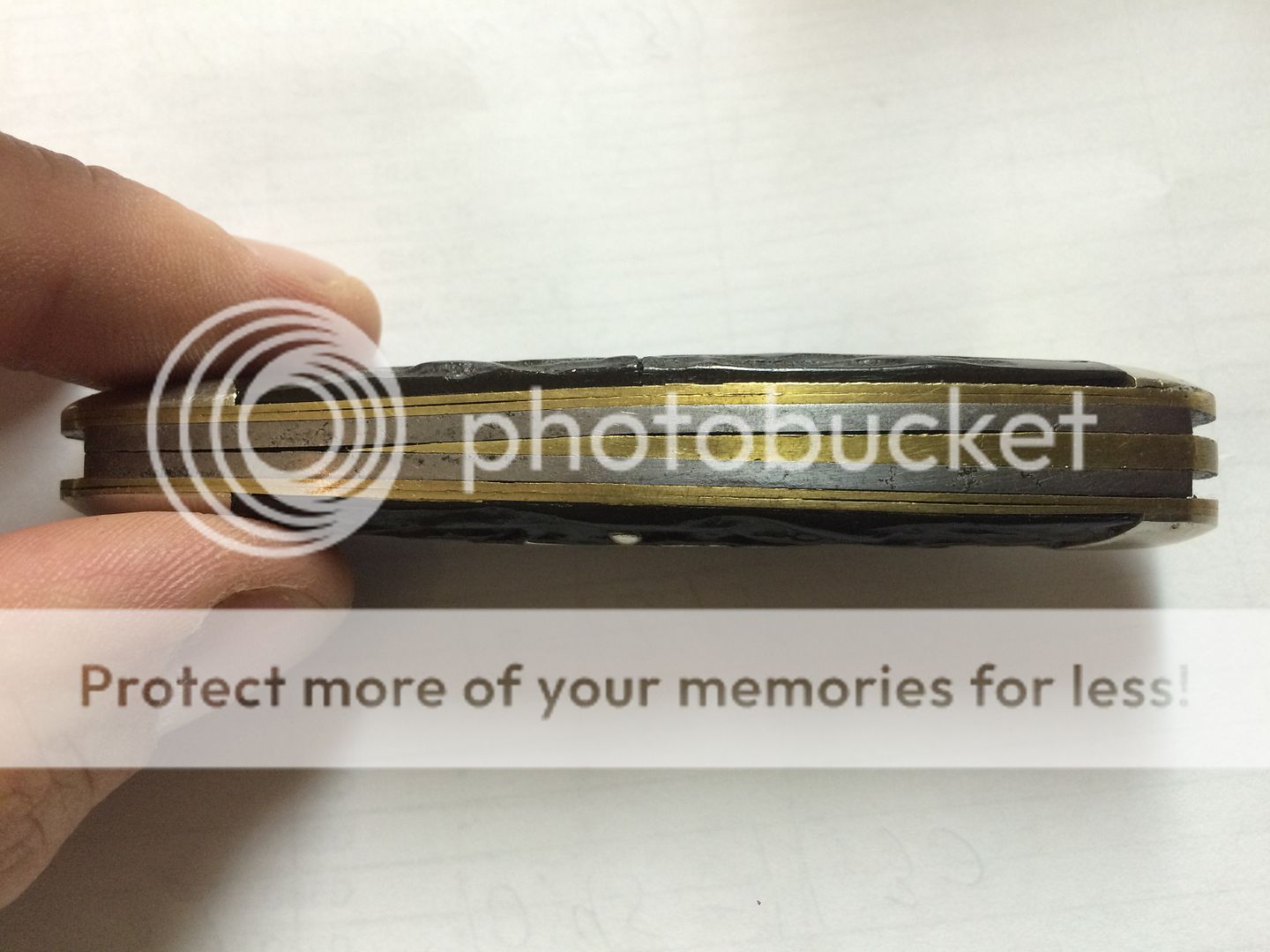

The wedge in the spring is a 90° triangle, not an isosceles triangle like it should be!
You can see how bowed it is with the straight edge of paper against the liner:
It's so bent that it broke the plastic scales!
