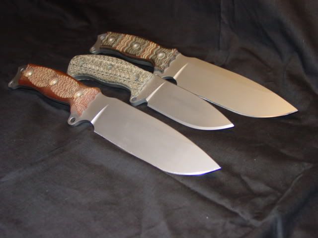

I think it turned out pretty good. There's only only one bad spot, right at the bottom of the handle. I really didn't notice it until I started taking pictures. I took the handles off like a moron :rolleyes: and now I guess I'll have to put them back on with the ole style fasteners. I'm going to do either my NO-E or my BM-E and leave the handles on. :thumbup:
<center>
Here's a couple of before shots. You can notice a gouge in the crinkle coating on one side. I bought it that way from a private individual. It was unused and unsharpened, just had a big gouge in the crinkle coating. It didn't scratch the Infi though :) . I also scrubbed the handles to get them clean. I carry it in a pouch sheath and you can see how far the sheath comes up on the handle.

Thanks for the compliments. I'll be honest, I was really wondering what I was getting myself into when the job started. I did strip it before I had the blasting done. There was a little bit of black coating on it when I gave it to him. The handle blasted fine but I will be getting the blade good and clean on the next one before it gets blasted. You can't really tell on the pics but if you hold the BA-E at the right, well I guess it would be the wrong angle in the light you can see what looks like the shadow of a stain on the blade. Here are some comparison blade finish shots with two Busse Factory DCBB SFNO's.
He charged me $20.00 which I was happy with. The blasting was fast. Switching the machine from sand to beads took a few minutes.

That came out sweet. That stain is not even visible in the first set of shots and once you put it to work you'll never notice it again. A very nice bit of work. :thumbup:

Thanks for the more info Silas. Can't really notice the stain that much... I think I see what you're talking about. In the center of the blade. I swear from the pics it looks every bit as good as the factory DCs. This might not be the case up close, I'll be finding out soon. Just ordered my beadblaster and abrasive from Habor Freight. From what I understand, Jerry puts a satin finish on the knives then beadblasts them. It sounds like a lot of trouble so I'm not positive that is his actual procedure. I would think it would make the DC knives more expensive then a satin finish knife. But, it difinitely would insure no blimishes. Now that you've experienced it for me, I'm thinking I might hand sand my Ratweiler some prior to blasting. It also has some black still on it.

The stuff I used for my NO-e was "JASCO Premium Paint and Epoxy Remover". It works very well on the smooth areas, but left some residue in the dimples.
Micarta is very tough stuff and you don't need to protect it. As I understand it, the folks at CRK don't even mask the micarta on the inlaid Sebenzas when they refurbish them in the bead blaster.

I would definitly leave the handles on. I will be leaving them on with the next one. I do recommend doing a good job of stripping and sanding the blade though. I would also recommend the Jasco paint stripper that the others have mentioned. They were sold out so I bought the cheaper stuff and BOY did it suck. I had no where near the results the others did. It took forever and there was alot of strenuous sanding involved. GET THE GOOD STUFF! I'm thinking of resanding the blade on the BA-E and running it through the BB again. I should just be worried about getting the handles back on though.
1. Strip with Jasco, the jelly not the spray.
2. Do a good job sanding the blade, by hand.
3. Blast with sand
4. Blast with beads
5. Go pick up women. The Ladies dig DC. :D

What you need to do this right is CERAMIC beads. This is what Kit Carson and I believe Busse uses. Much better than glass beads and really does 'ping' the metal shut. Big difference between glass and ceramic beads. If there wasn't, I doubt if Kit would go to the added expense and Busse mentioned ceramic beads, not glass.
Also, very expensive, but will go through the blaster 12/15 times rather than the 2 or 3 of the glass. Also it dissintragates rather than break up so there are no sharp edges to cut the metal.
The name of the stuff is ZIRBLAST and is made in France, thus the high cost due to shipping. I think what Kit reccmd was ZB-60. I have all the details in my other computer if you are interested. It may be worthwhile to split a 50# pail with someone as, IIRC it's around $250 for 50#.
