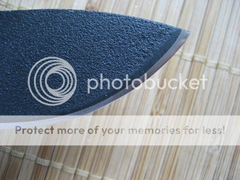

I love my new BK16 but the edge was way to obtuse out of box. So I broke out my 1x30 belt sander and went to work. The edge is a heck of a lot better and this thing really slices now.
After sharpening
Close up of how high up I went
Close up of edge
Tried my best to keep the edge symmetrical

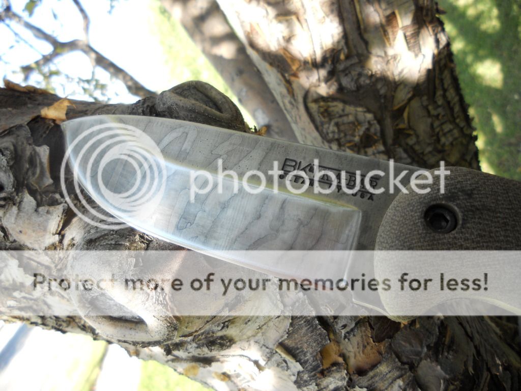

This is mine after I convexed it.
And my 17.
My 15.
My Fisked 2.
As you can see, it's pretty close to what 12Bravo did to his. It makes these suckers really sharp.
