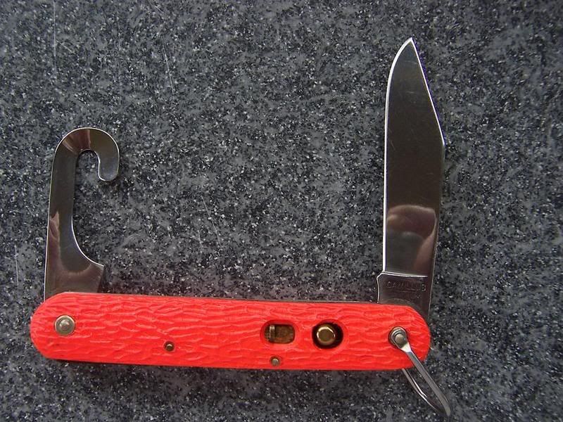

Just for grins I thought I would post the Camillus example I own for a visual. Other than the Camillus tang stamp in three lines: CAMILLUS {over} NEW YORK {over} U S A , I can find no other markings on this knife.
