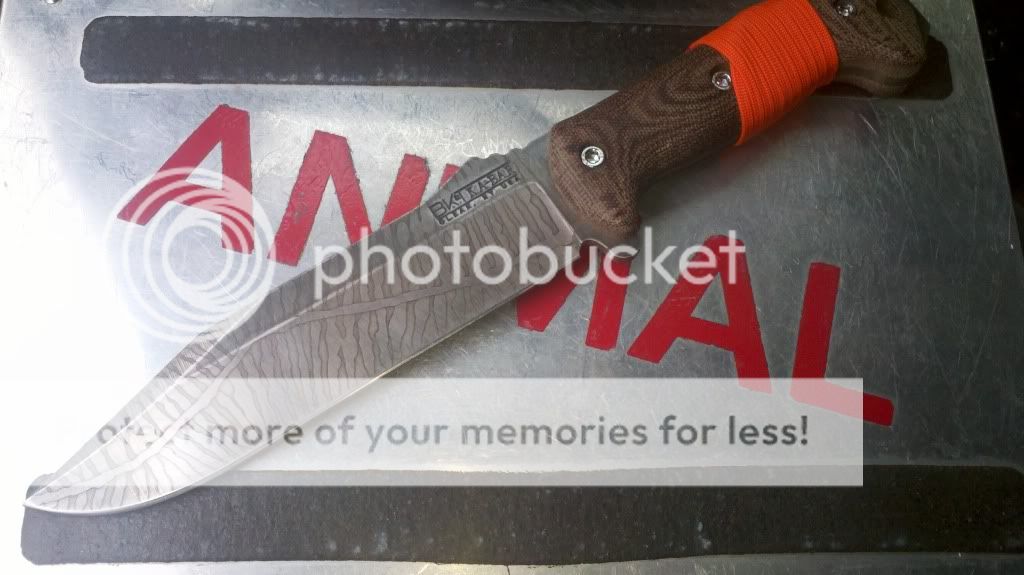

Why I am considering it is because I have 2 9s and I was thinking about keeping one old school and making the other stripped with either olive drab tinted micarta grips or blonde...driving me crazy!!!!
Well you don't need 2 black bk9's, strip it then etch it. That would look sweet w OD micarta maybe with dark red liners :D
If you strip it, you could always leave the coating under the handle scales to prevent rust. It's not hard to do. There's even a how to around here somewhere.
Yeah I was wondering about that little thing going on under the hood..wouldn't a good ol patina work out for the undercarriage (under the grip).
I live in one of the most hot/humid areas of the US and have never had an issue with rust under the scales. I wouldn't leave it submerged in salt water for a month, but otherwise, it should be fine if you give it a coat of oil once or twice a year. Of all my non-stainless working knives, the Beckers seem the most corrosion resistant even when stripped. I have a stripped BK2 that lives outside on one of my tractors and after two years I've only had to rub a few specks of red rust off the spine. 10 seconds with a drop of oil and a Scotchbrite pad took care of that.
And I think stripped BK9's look good with micarta:
