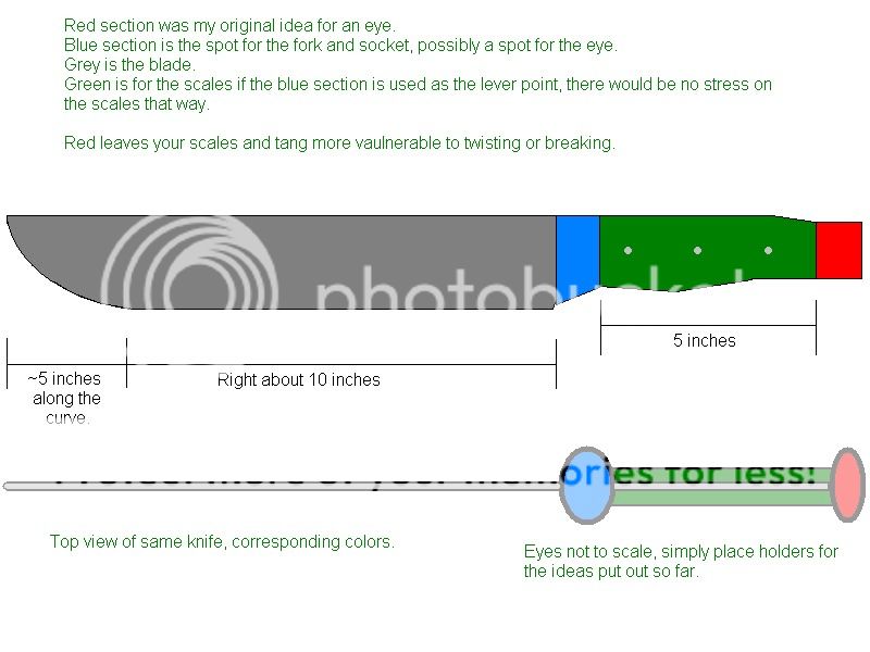

Would it be possible to make a knife with a hole at the end of the handle to accept a piece of wood to make the knife a functional froe?
I'll add pictures if my idea isn't translating with words.

I found a fault with what I had in my head, well, maybe, I'm no metallurgist.
I've got my RAT 7 in hand, so that's what I can visualize with at the moment.
I see an eye behind the micarta slabs, kinda like a giant lanyard hole but like 42blades mentioned earlier "In line with the blade" not perpendicular to it.
What came to my mind is a couple things, this would definitely suffer with a skeleton tang, that and the amount of flex the tang would have to endure might be a problem for long term use as a froe, or even short term should one take on something too thick, it could break the handle and would probably break the slabs off in short order.
The slabs issue may be remedied by a synthetic rubber like santoprene or something along that line, but that doesn't solve the possibility of the tang suffering damage or breaking from the stress imposed as a froe.
I still like the idea of this, it adds girth to the pommel which is great for when you're chopping.
what if you made the eye for the froe as part of the guard?
You could have a couple of slots on each side of the tang, then a fitted piece with two tines (picture like a tuning fork w/ one tine on each side of the tang) that slides onto the tang then transitions to a socket that you could fit a handle to in the field. There could be a pin to retain the fork. I would think you would need a fairly deep blade, say a couple of inches, to get the kind of torque advantage you'd want from a froe.

what if you had an oval cross section on the knife handle and you had a fitting or something that could go over the butt end of the knife but be attached somehow to a stick that you rig in the field?
or maybe the butt end of the knife is a rectangle, sort of a tenon, and you fit it to a mortised long handle. the mortise could be reinforced with some sort of metal u shaped section that you slide on to a carved stick to keep the corners of the mortise notched in the stick from cracking. Does that make sense?

Ok, here's about the best I can do for a visual representation of what's in my head.
Edit: Just had another idea, if red section were used, flat head screws could be used to loosen the scales and allow for some twisting without damaging the scales. A SAK/multi-tool could easily handle that.
That drawing makes sense to me. I'm inclined to think twisting from the middle of the overall length (blue) would reduce the amount of torsion the blade would have to handle, since there is less length to twist before it hits the part stuck in the wood.
Another thought... if you want to twist from the end (red) maybe you could have a wrapped handle. Maybe a hemp wrap like the wildertools knives that Magnussen does, or a built up leather or paracord wrap. I bet that would handle the torsion just fine and wouldn't have to be altered.
Here's another thought... what if you just had a hole through the blade, and then fit a pipe through it perpendicularly to make a plus sign? You could get a pretty good twist on it by pulling up on the pipe like a t-handle wrench, and it wouldn't take any special fittings at all. If the edges of the hole were rounded or if you had a collar the fit the hole, you could probably even use a stick of sufficient thickness.
That could work too, but like I said, I'm dumb as rocks when it comes to how the steel would handle it, that and I'm not sure how well it would handle controlling the angle of the blade while batoning, I think an upward handle would give more control than a perpendicular one.
