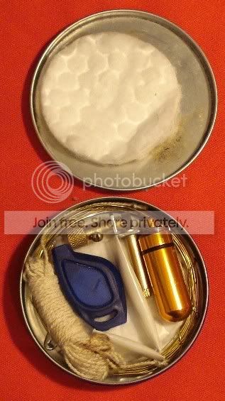

Well I think everybody, or at least most of you have posted pictures of your PSK. Well, I felt left out, so I bought a camera, made a PSK and I'm damn well going to post it.
In the first picture (with the obligatory knives) you see 2 jute pouches, one with a PSK inside and one with it on top. The number 1 refers to the first survival feature. It is a small aluminum container that has a couple of layers of duct tape front and back (that can be used to attach, bind or seal). It is also sealed with duct tape to make it water proof/repellant. #2 refers to the jute pouch. It is made up of approximately 110 feet of jute, which can be unraveled (as easy as daisy chain after the first row or two) and used for fishing line, bow drill cord, tying things together, etc., and of course, as tinder.
In this next picture, you see the PSK with the lid removed. You will notice everything fits in there pretty well.
Picture 3 - this is a breakdown of the actual components in the kit.
3- waterproof aluminum container in which is:
4- a rare earth magnet which functions as a compass. It is placed on a leaf, piece of
wood, etc., and floated. It will align itself with magnetic north/south.
5- tinder (dry cotton)
6- standard lighter flints which fit into -
7- modified Coghlan's lantern lighter which can light pretty well anything that can be
lit with a firesteel and can be used one handed to boot.
8- mini firestraws
9- leather awl needle that can be mounted in piece of wood for use
10- 3 various sized fish (or any other critter you fancy) hooks
11- cotton cosmetic pad for tinder and to prevent items from rattling in container
12- 19 feet of cordage (material unknown but strong and I use this for making poacher's
nets [and before anybody gets too excited about this, it's just a name for this style of
net])
13- 3 safety pins to hold your clothes together or used as a gang hook
14- LED micro light to find the mix for your whisky in case it's dark out.
15- 15 feet of brass snare wire for obvious use or tying things together, etc.
16- an American dime for size comparison only

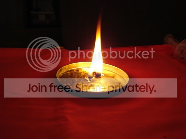

Now in case you think that the mini firestraws are ineffective:
Burnt for approximately 1-1/2 - 2 minutes.
I make my firestraws a little different that most people. I use a wound irrigater (?) to
inject the petroleum jelly into the straw. First I put in some cotton, then some pj, some more cotton, more pj, and lastly some more cotton. I put cotton in last to help clean the pj away from the end of the straw to make the sealing a little less messy. Hopefully, you can see in the following picture, how this is set up.

Do you use liquified or warmed PJ and then inject it into the straw ?
Going to have to try that for sure.. Now to find my syringes...

troutfisher13111 Nice kit! The jute pouches are very original. Are they something you came up with yourself?
Yes. The idea started with these small hand cream cans my wife buys. 3" in diameter and 5/8" thick. I made them so you kind of have to force the can into the pouch (won't fall out readily). I also envision stitching up the rest of the pouch, once the can is in, to prevent playing with the contents and finding out something's missing when you need it.
Normark: Do you use liquified or warmed PJ and then inject it into the straw ?
No Eric. I just used the Vaseline as it comes out of the jar.

I'm just now making a kit myself and have a pretty good start but I'm on the look out for new ideas. One thing I would like is a one hand fire starter so could you go into more detail about how modified...the 'modified' lanter lighter is. Great idea.:)
Hey Shotgun,
Remove the screw thingy that holds in the flint. Remove the screw that holds the twister knob. Remove the sparking wheel and shaft from the brass sleeve. Remove the 2 nuts and mounting bracket. Shorten the brass sleeve to whatever length you want, shorten the shaft of the sparking wheel, remembering to leave some extra to reattach the twister knob. File a 'flat' on the sparking wheel shaft for the twister knob screw, and that's it. Please forgive the adlibbing on the parts terminology as I don't know what they're called. The whole mod is pretty self explanatory, once you jump in. If you have any problems, I can do some drawings and get more specific, but you probably won't need it. I would recommend that you don't shorten the flint/spring tube, though. Plus you need something to hold on to if you're using 2 hands.
