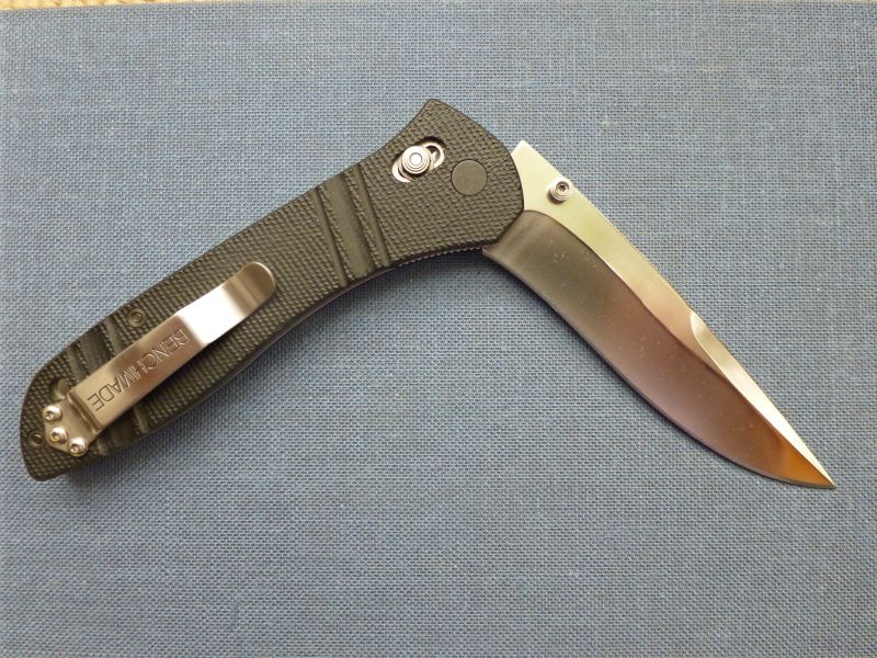

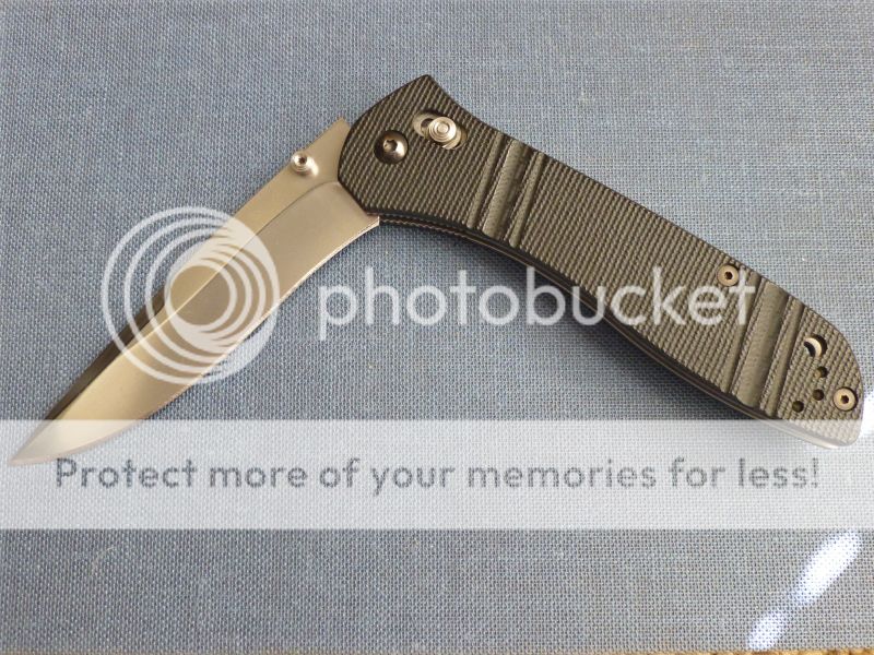

Some have seen this, some haven't. The BK coating failed on this knife, cutting cardboard it basically started flaking off. With the help of my friend Skimo the following 710 sans BK is the end result of a lot of hand work and it turned out really well. No worries either, sent it up to LifeSharp after the final polishing and was complimented on it's looks:
My suggestion after all of this? (Yes that's dust on the blade...) Send the knife up and have the blade replaced for $25. :D
25 bucks? That is a great bit of info. I did not realize I could do that. Your knife looks amazing. I am tempted to do my 710 like that also, but I will restrain.
I definitely will be doing the clip on my Grip, nice work and thanks for the photo's.
How did you polish the blade? Great job.

All handwork; 320 grit sandpaper and liquid brasso to pull the coating off, followed by 600, then 3M fine sanding sponges, finally polished with Flitz for the resulting high shine. I'll let go of others but not this knife after all that.
