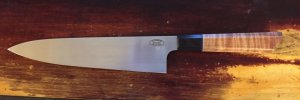

This was my first attempt at any kind of wa-ish handle and my conclusion is that I should have probably tried a regular straight one before I went with the "dropped" version. ;)But, it turned out semi-okay so it will be a housewarming gift for my brother and his wife. 225mm overall with a 210 cutting edge, 48mm+ tall at the heel, around .100 at the neck, so not a laser. full height plungeless grind. 600 grit hand rubbed finish and the edge taken down to like .007. Old growth Brazilian rosewood ferrule with blue G-10 and curly maple with a red alkanet root oil finish. I am a pretty ham fisted sharpener but after knocking the corners off with a worn 400 grit belt and less than 10 minutes on a two sided 1000/6000 grit King stone and a flesh side strop, it will do the basic stupid knife tricks like push cutting newsprint.
Thanks, Darrin. How many of us have been pleasantly surprised by this ancient stainless steel that clearly doesn't have enough carbon nor any of the magic alloying elements required to make a proper high end knife? :D
Thanks, guys. I have a couple of full tang ones being finished up, but I think that the next one will be a 270 suji with an all blackwood wa handle maybe with a thicker spacer made from that blue G-10. The spacer on this one is .062 material that I have been using for liners, so I may try .093.
AEB-L makes some of the very best leather use knives I've ever tried. that is all.

Paul, this batch of kitchen knives were heat treated a while back by Peters using the "standard" recipe. I can't wait to see what this stuff will do using something like the Devin Thomas multi-step process.
