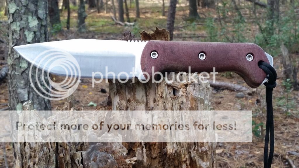

made these from a scrap of T&G bamboo flooring

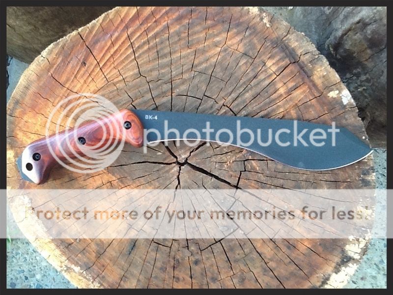

I have used wood and micarta (factory and sheets shaped by myself).
My 2 with factory micarta dyed maroon:

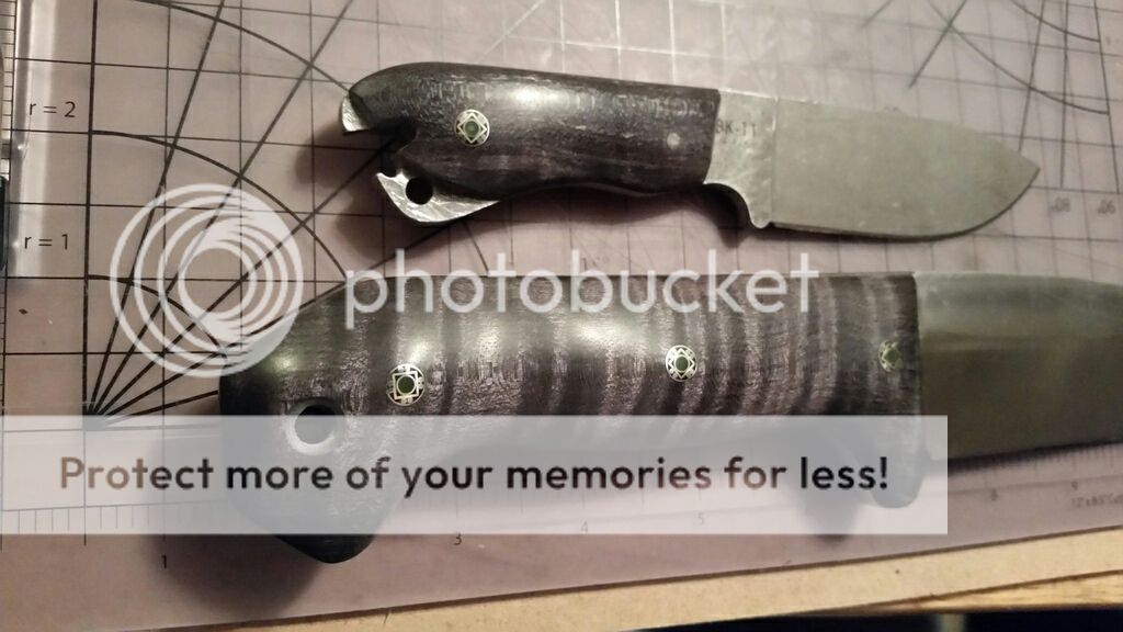

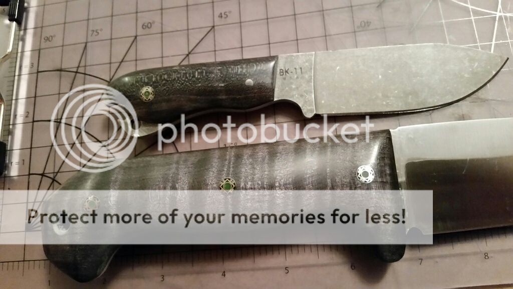

A BK10/11 combo I did for Gonebad395 in Black Curly Maple:
Both knife handles came from one block of wood. Using a scroll saw, I removed the material from the underside of the handle of the 10 and used that to make the slabs for the 11.
Due to this, the 11s tang needed some slight tweaking, but I was polishing the ricasso, spine and tang anyway, so that didn't matter.

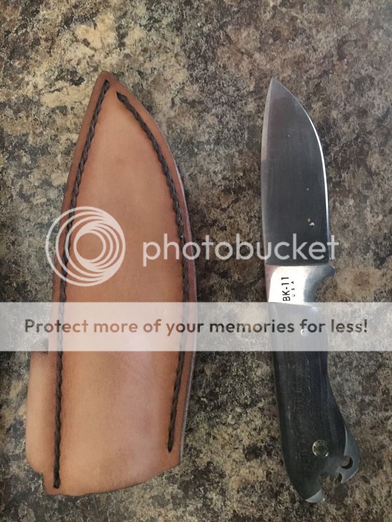

Finished up with sheath, blade reprofiled and swedge added.
Edit to add: I forgot that I had opened up the front finger choil a little bit as well (knife still fits factory sheath).

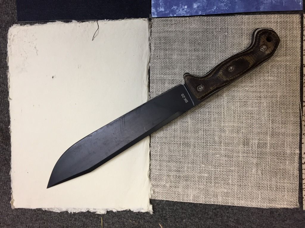

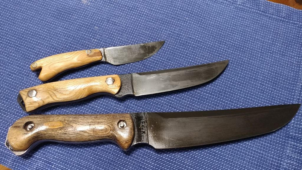

The 20 has one of my first sets ever. Burlap from the fabric store, Bondo resin from HD. Pressed together, cured, and shaped. Actually from my 7 - was just test-fitting here.
9 has one of my most recent sets. Bought the scales, made the liners, reshaped scales to fit, and refinished.

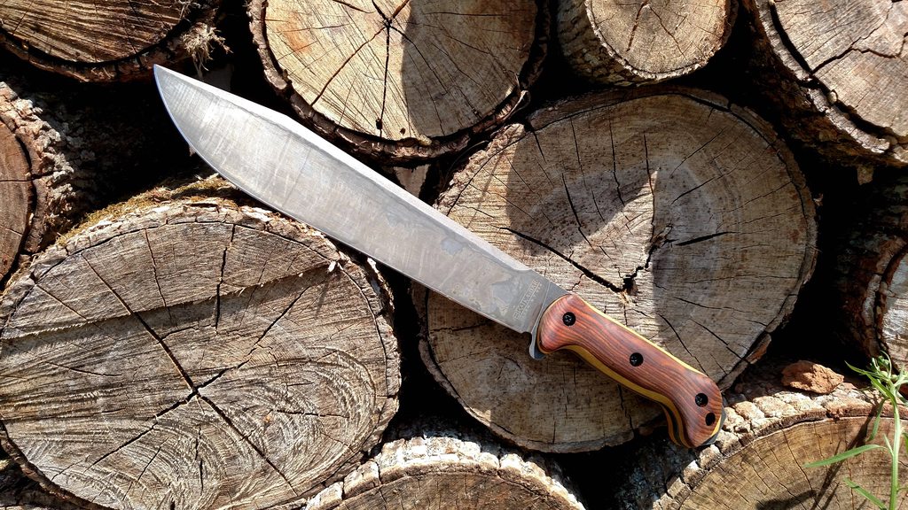

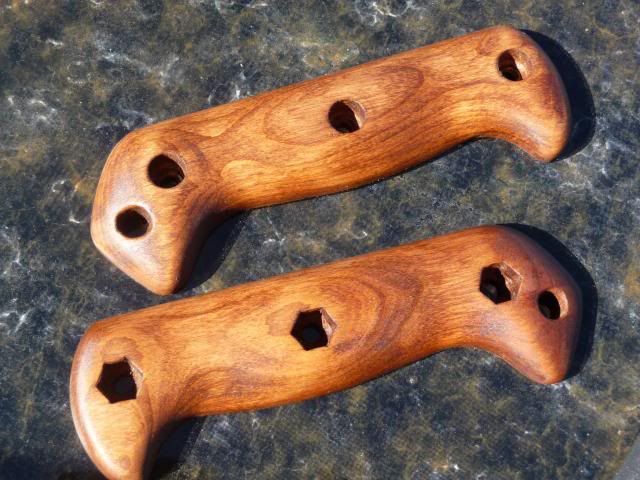

5 and 15 have scales fashioned from a branch off a neighbor's elm tree after it had to come down.
Used files and a belt sander for most of the work.
I used a dremel for the holes in the mycarta; drill press and tiny bit for elm.
I just hand-refinished the elm scales on all three knives (there's an 11 in the set, too.) Just waiting for final coat to cure.

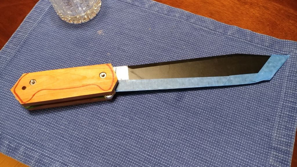

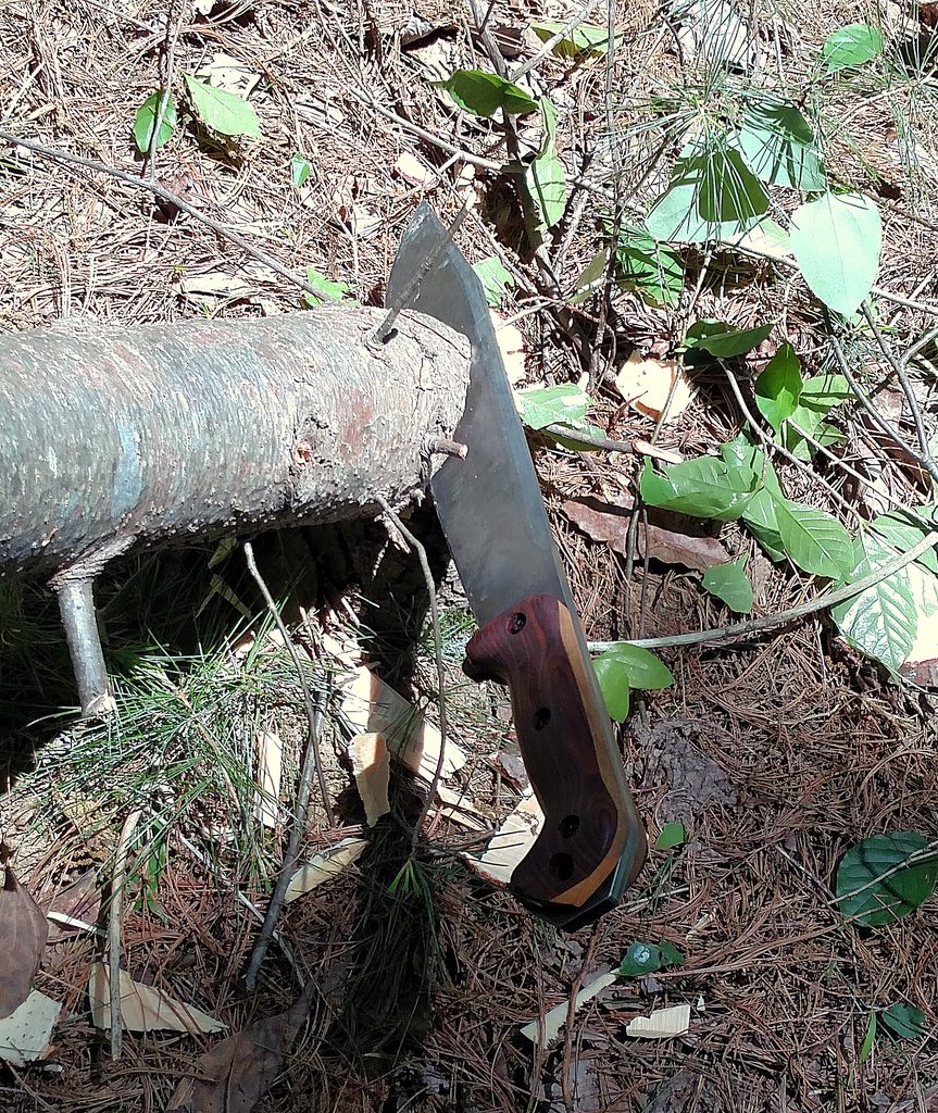

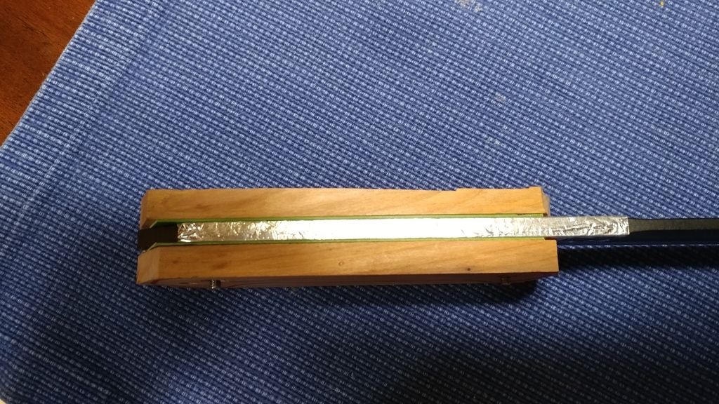

Had to cut down a cherry tree in the backyard, and pressed the 20 into service for some of the delimbing.
I think it has earned a set of scales made from that tree. When I find the time again.

Refinished the elm on the trailing point set.
Sanded to 800, and finished with 4 coats 50/50 tung oil & mineral spirits, followed by 3 coats tung oil, followed by two coats Formby's low-sheen tung oil finish. The buffed with white (120 grit "cleaning") scotch-brite.
Since these are my camp kitchen knives, after about a month of curing, I'll seal 'em up with some butcher block conditioner.
Also started the cherry scales for the 20. As a chopper, grip is key, so I'll probably sand to about 220 grit and stick with the pure oil, and skip the slick "oil-finish" step.
