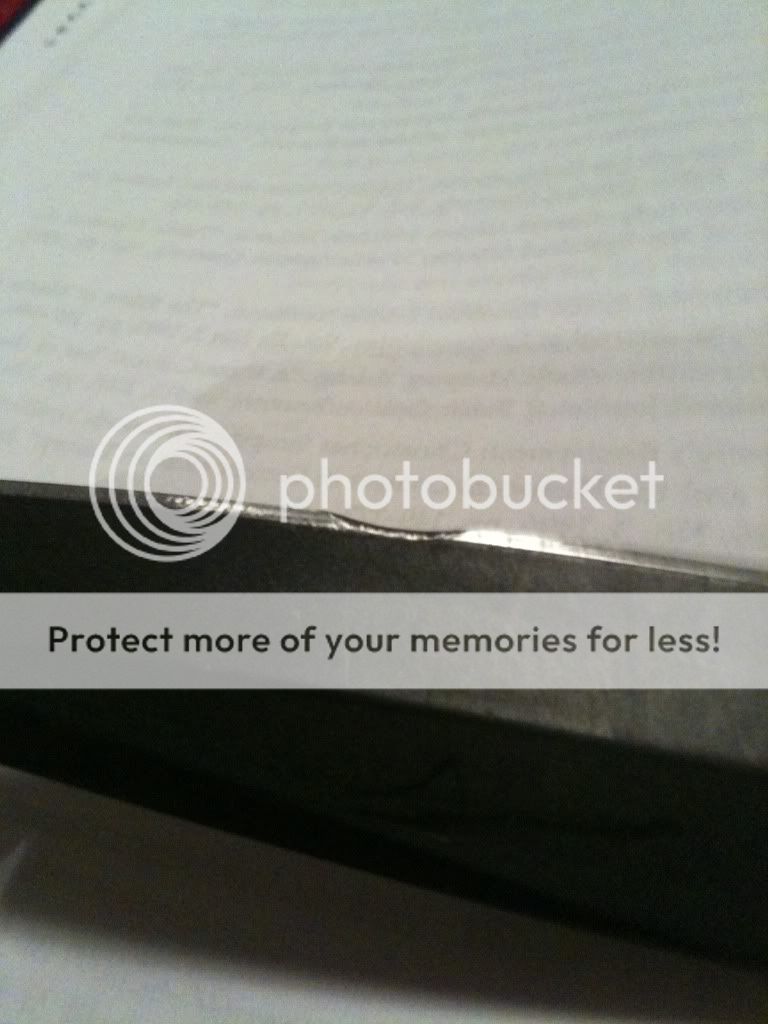

I rolled the edge. I bought a short tanto kabar early last spring and dropped it out of a tree a few weeks ago. Managed to roll the edge, right in the middle of the blade. I tried to sharpen it, but just couldnt get it to work.
So what should I do? Do i just junk it?, or can i re-profile the edge to make the "dent" go away?

The dent is pretty deep, so i wasnt sure if just using a stone would work.
Pics -
Its deeper than what it looks like, but you get the idea
That's a pretty serious deformation!
You would need to completely reset the edge bevel to remove that. Power tools or a bench stone around 100 grit would be needed.

That can be fixed....though that's a lot simpler fix for one of the makers/sharpeners with a belt grinder as you need a pretty solid re-profile done. Definitely don't toss it, it's totally fixable. You'd be working on that quite a while with a stone.
Basically the new edge will wind up at the base of that dent...that's a lot of steel to balance by hand with a stone. That's assuming you want the edge straight. Otherwise you could sharpen the dip like a big serration...me, I'd just send it off to someone with a grinder.
Oh yeah...that's fixable. KaBars are built to take a beating. Short of breaking the blade clean in half, just about everything is fixable. I have put points on several Buck 110s the people snapped off prying the metal "cork" out those cans of Coleman White Gas.
Just don't take a bench grinder to it...that will ruin it. If you need it in the short term, before you can find somebody with this right tools and/or skills, you could just sharped up the dent as best you can and deal with it. With a big knife like that, a jagged, sharpened divot won't really hold you back for other tough cutting chores in the meantime.
