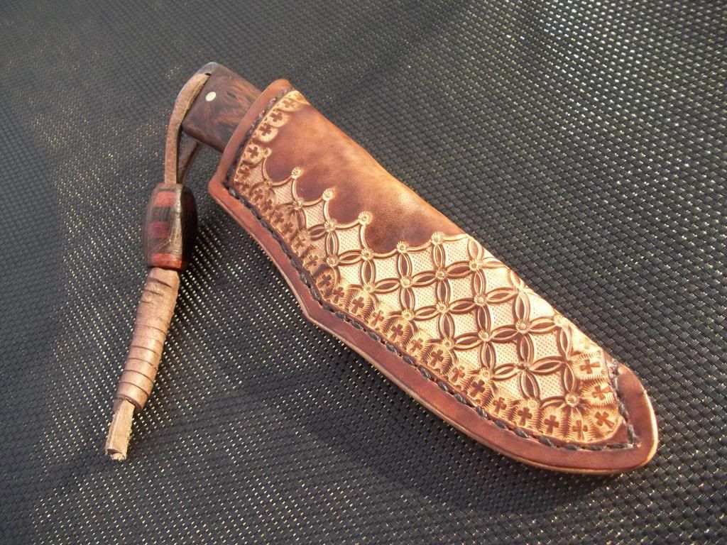

A week ago Friday I went out and visited with a great knife maker. Many of you know him... Alan Davis. I live not too far from him and he was gracious enough to have me out.

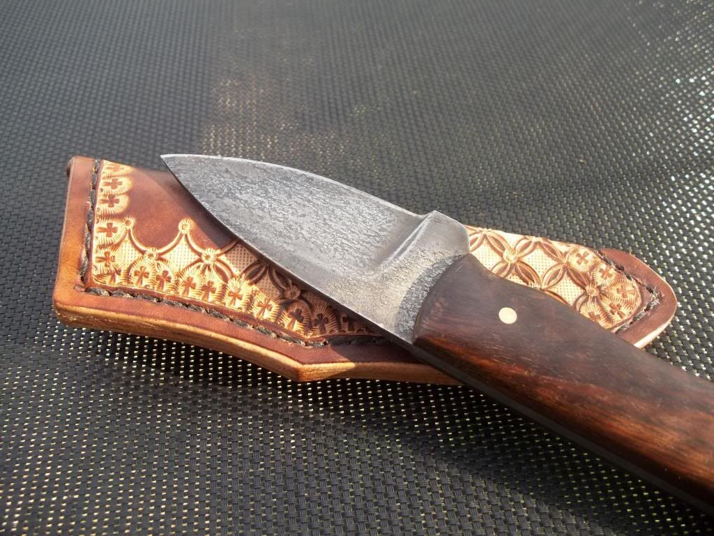

We selected some 1080+ to make a fixed blade knife from and I went to town. Short of some instruction and a tiny bit of cleaning up of the plunge line on one side I made this thing myself. The final edge was applied by Alan as well. We cut, ground, heat treated, tempered and patina'd this little bad boy in one afternoon. When I left I had a cool little knife and homework to apply the scales.
Specs:
1080+ steel
6.25" total length
2 7/16" edge
Forced patina finish
Brass pins
I'm not sure about what wood the scales are, Alan Pulled about three sets and told me to pick one.
Handmade bead from a pen blank.
Brown latigo lace lanyard
I want to thank Alan for a awesome afternoon and his hospitality. I hope I can talk him into having me out a few more times as I have a few design ideas for number 2,3,4... lol

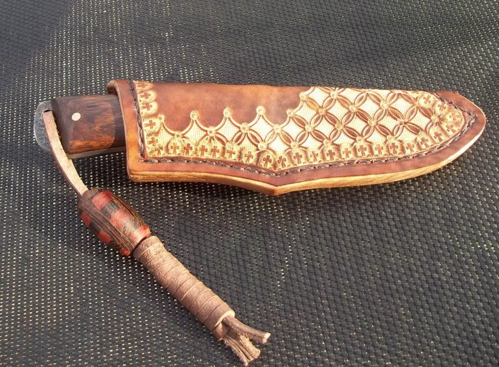

I made the sheath, the wooden bead and the lanyard myself as well.
The sheath is hand stitched and stamped with a geometric stamp and my new favorite border tool.
Specs:
Wayne Juesche Geometric Stamp
Ellis Barnes lined seeder stamp
HTA "Promise" border stamp
9 oz Hermann Oak leather
Waxed thread
I hope you like it and can see passed a few of the flaws. I am excited to try another soon.
Thoughts and opinions, critiques and praises wanted.
Thanks for looking.
J.
PS If this is in the wrong spot please feel free to move it.
