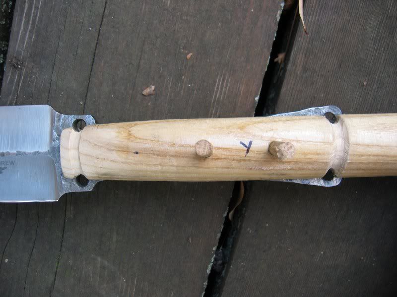

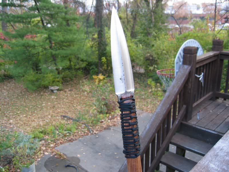

I wasn't sure where to post this but figured this was as good as any.

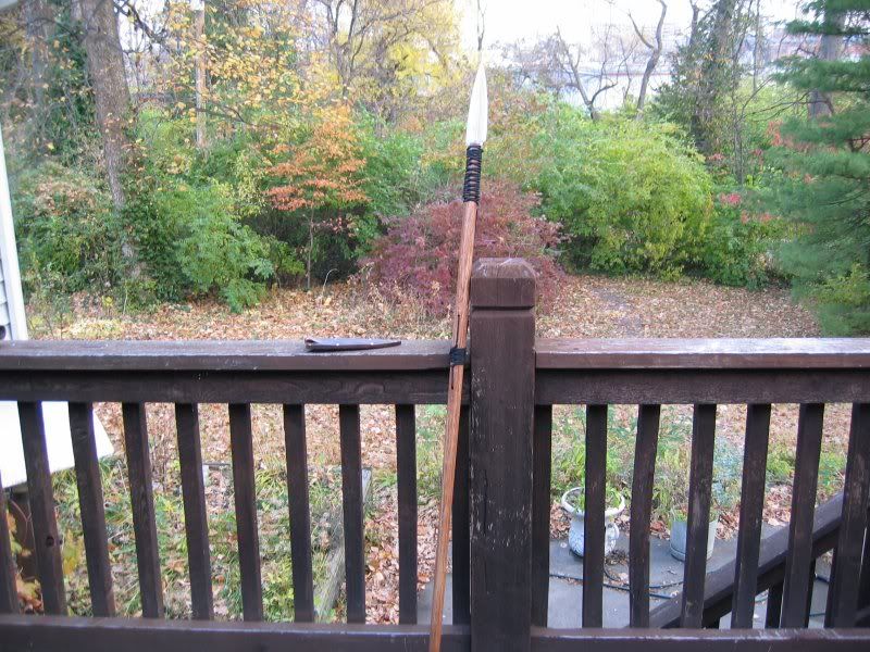

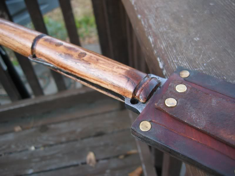

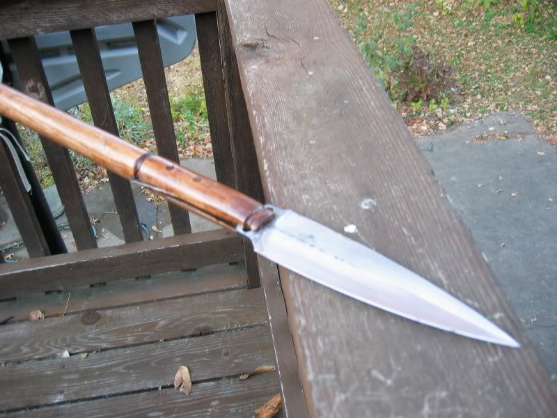

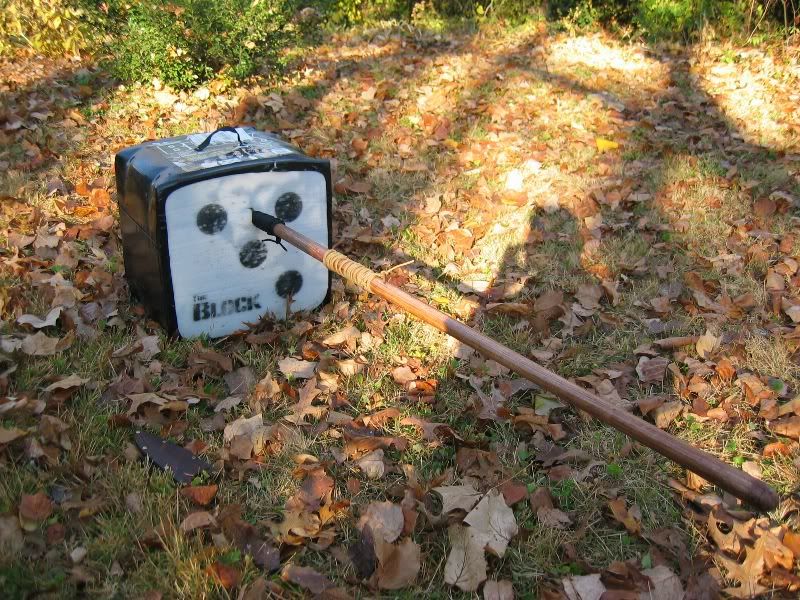

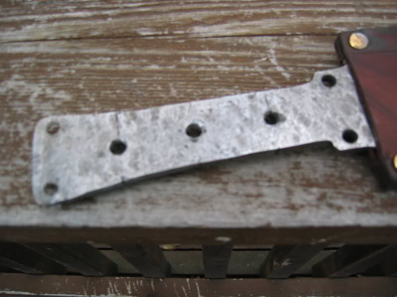

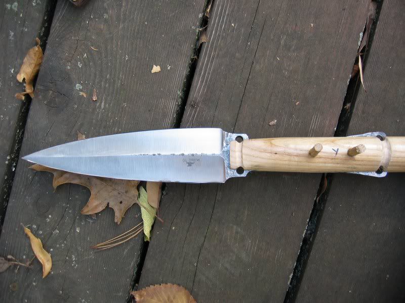

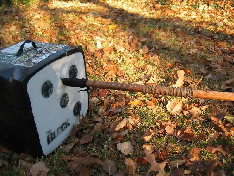

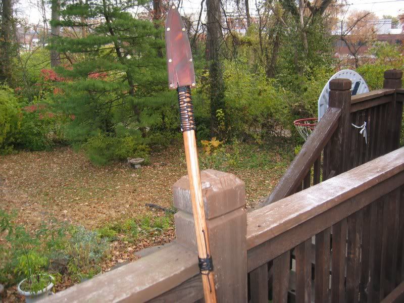

I bought a spear head from GL Drew not long ago and here is what I came up with. The head was forged out of 5160 and was meant as a survivalist type blade that could be quickly attached to a sapling or similar shaft. The edges on this thing are VERY sharp and probably too thin to make a stout throwing instrument. I imaging the tip would break pretty fast if thrown into a tree.
http://www.bladeforums.com/forums/showthread.php?t=783883&highlight=spear

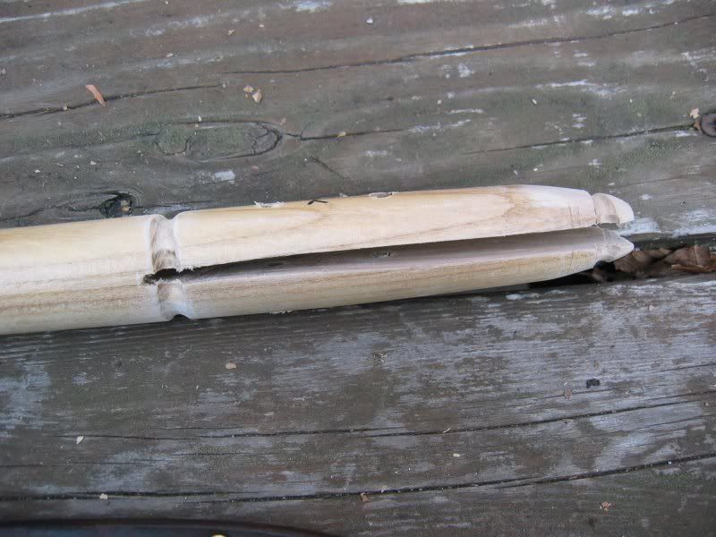

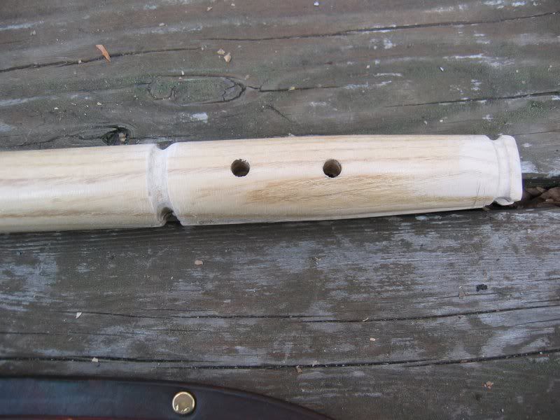

I used a rake handle from Lowes and all the work was done with a hacksaw, hand drill, files and a Dremel so don't be raggin' on me about the poor craftsmanship! I need to work on my cord wrapping, this was just a quick job and I plan on doing a separated one for the balance point.
Hope you guys like it. It was a fun project to do.
