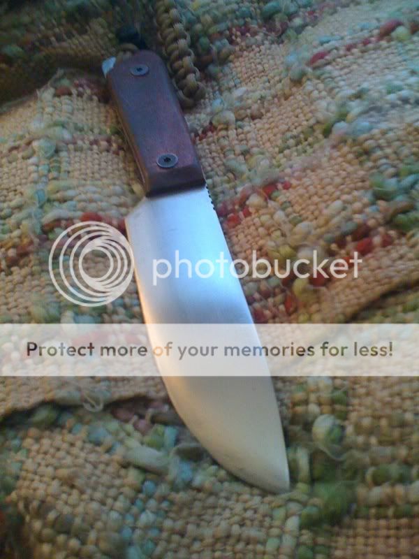

I made my first knife let me know what you think.

its not quite razor sharp, this was my first attempt with only a few tools.
Most of the time i had no idea what i was doing. But it looks ok. Tips would be great. thanks Bladeforums

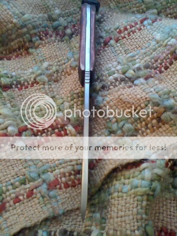

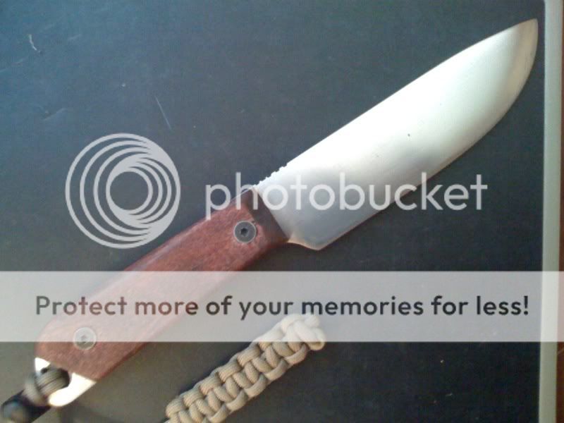

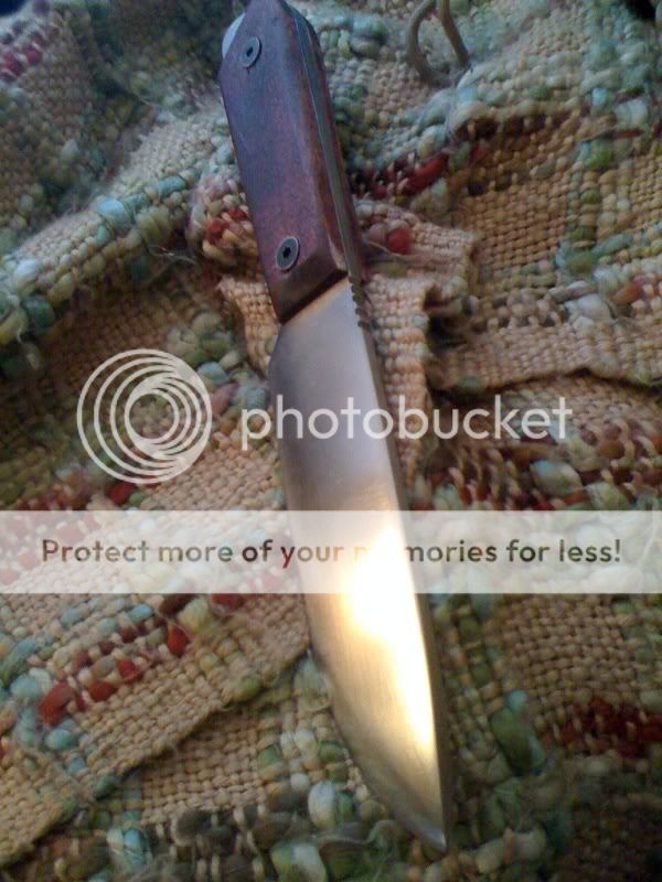

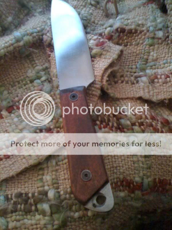

Looks pretty good for a first try. It looks like the grind is a little off and the wood could maybe use a little more contouring but that is to be expected. I think a little more practice and some better tools and you would get it more even as you learn the little tricks. Good job!
Nice job. Check out the Maker's forum on this site. The real experts reside there.
Back to your knife, really nice work on the blade. Looks like a great flat grind. What did you use to grind the blade?
Also, I like the hole in the tang and how you left it exposed from the scales for a lanyard.
thanks. I used an angle grinder for the blade i wish i had access to a belt grinder but im on a budget right now. the handle is temporary im gonna duracoat the blade to prevent rust.
other then that i just sat in front of the TV and sanded the hell out of it

I love the blade shape. I have always liked drop points.Nice first knife.
Looks good! It looks like a nice camp/utility knife.
