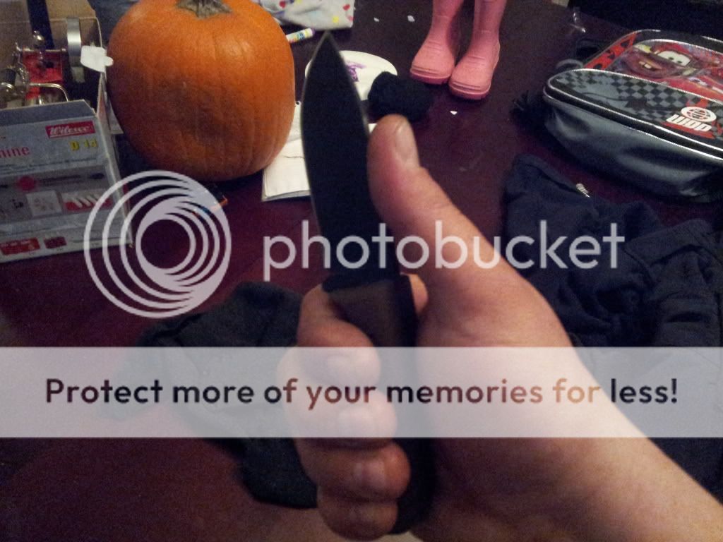

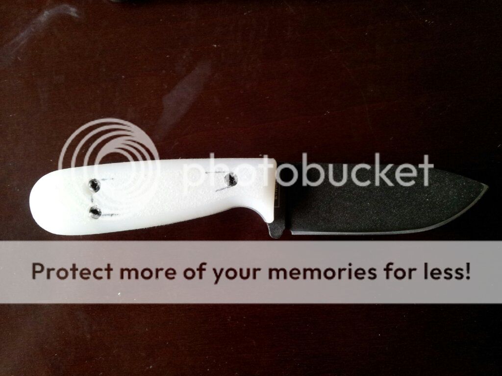

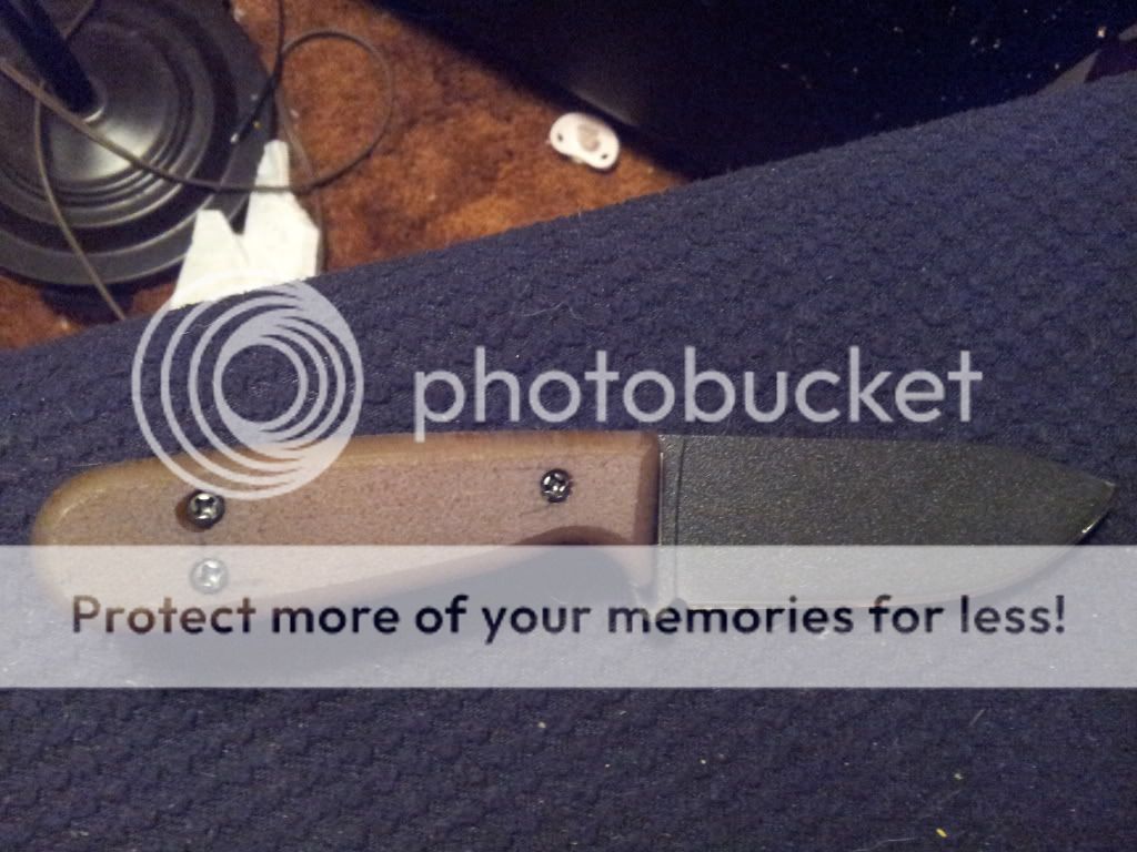

So I made my first set of handles and my bk14 was the recipient. They are made of uhmw plastic from work, and I had our sandblaster give them an aggressive blast for texture. After they were done I dyed them brown. Also had to trim the original sheath to work again, interestingly enough, it fits tighter now.
Pretty cool. Scales sure make a world of difference on the 14.

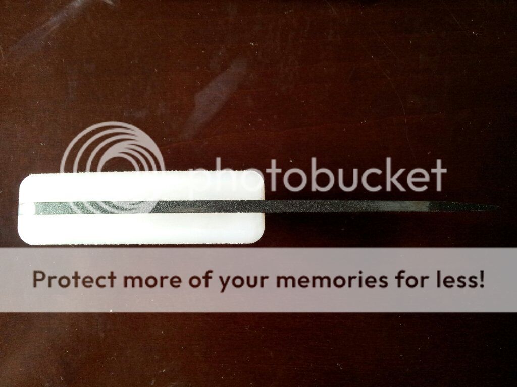

Well I have larger hands so for me the knife feels 100% better. I had a bk16, gave to my dad for his b-day, felt the handles on the 16 were a little thin for me, my bk2 is just right, so these handles I made feel good for me. By the way, the handle thickness with the knife thickness included is 15/16ths of an inch.
those look awesome. is the white one really as white as in the picture? i'm curious on how white it'll look with excessive use. i've been wanting to make some with other materials besides the usual wood.
When they were white they got dirty fast, they were filthy just making them, but brake clean cleans them up nice. I wouldn't leave them white that's why I dyed them. I think they just loom better dyed too.
Nice work! I really like the finished look.
Did you use a belt sander to shape them or just sandpaper & elbow grease?
I used a beltsander to shape them, a diegrinder with sandingdrum to do the choil, then a router with a radius bit to round the edges, and a little elbow grease.
