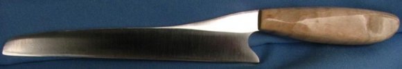

i made this knife for a friends wedding
Apr 1, 2007
10,080
i made this knife for a friends wedding last month. the blade is made from m4 that came from a power hacksaw blade. i wet ground the blade to keep it cool and save me time from having to quench it.
the knife is 9 7/8" overall and the cutting edge is 6 1/4". the handle is tiger maple that the bride picked out.
the maple was home stabilized with car clearcoat by member joesouth but i put 4 coats of superglue on to give it a good shine. it was a last minute gift idea. i plan on making a plaque to display it on the wall.

How did you like working with the M4?

mack, tman. everyone at the wedding really liked it. it took about 4 hours to grind the bevel which is 3/4" wide and a full flat chisel grind (mack, you have seen how slow my belt sander runs too). that m4 power hacksaw blade is some hard stuff. grinding wet sure made it go a lot faster too but for some reason when i grind wet, i seem to grind my fingertips :D.
since i have over 20 hours total in making the knife, its going to be hung on the wall on a plaque. his wife wanted to use it in the kitchen but i told her i'll make another for in the kitchen. i did get them a couple of whustof kitchen knives.
that was the first knife i made from m4 but i did make a machete from some m42 for the same buddy and it holds a real good edge. you could have cut the cake and plate too :D.

since there will be grandkids visiting, i will round the edge to make it a little safer and to make sure they are not tempted to use it. i am even thinking of putting glass to protect the knife and lettering-artwork that my buddys sister in law will be putting on the plaque. i'll make them another knife with neoprene slabs that they can use for a kitchen knife that they can abuse.
