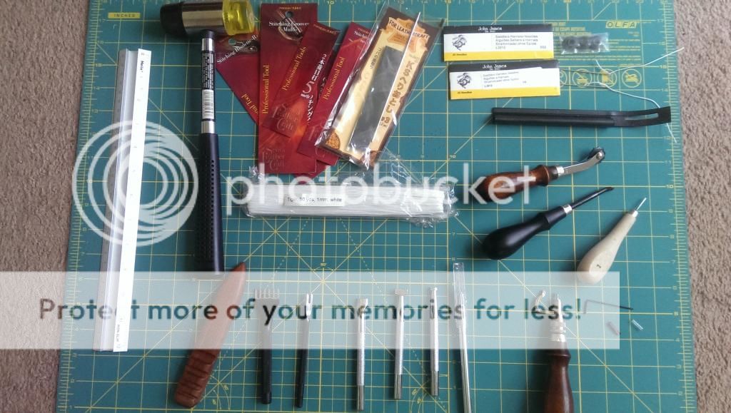

I went ahead and purchased the Seiwa tool. They sell another one of the same design with a green handle. The site claims that the Seiwa is the original design, and that the green one is a version of the Seiwa model. They cost the same.
I bought the Seiwa because it's about half of what some of the others cost (about $40 versus $80-100), I also really liked the look of some of their other tools. Their edgers come with a rod and what looks like abrasive paper to maintain it. I don't feel like I have a problem maintaining my bladed tools, but it's nice to see the company view their tools as a long term investment.
I'll let you guys know how it is. I paid a little extra for expedited shipping so hopefully it'll get here sooner rather than later. :)
Oh also, they sell a damascus bladed head knife that is from the OEM maker of the Stohlman knife. Not sure if it's a good deal at $140. I wouldn't buy a stainless knife anyway, I prefer carbon and tools steels. Just a personal choice.
I guess I should mention that all of this is from Goods Japan. They have an ebay presence, but I bought directly from their site.

Most of my leather working tools were purchased from Goods Japan, including the groover you are referring to. Most are the Seiwa brand. The groover also comes with a creasing head. It is definitely a high quality tool and I love using it. In fact, all of the tools I purchased from them seem to be much higher quality than their Tandy equivalent. Nothing needing sharpening to work properly. The awl and beveler are fantastic. I highly recommend the pricking irons as well. I may get away from grooving all together on my sheaths because of them. Anyhow, Goods Japan has earned my trust and future business. I doubt you'll be disappointed.
Yay, thanks for chiming in. :)
I had a good feeling looking at their product line. I thought about grabbing a #3 edger while I was at it and now I wish I had. On the other hand shipping is free so no big deal.
I don't like long shipping times, but their expedited shipping is very reasonable. Less than most domestic shipping charges so it should be fine.

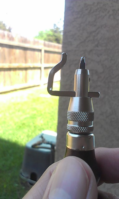

Groover just arrived. I'm glad that I payed the very reasonable (think it was like $4) expedited shipping. I've read that it took much longer to arrive for other folks.
The groover cuts smoooothly. There's a clear difference in how finely sharpened this one is. It cuts about the same width, but cuts deeper, so no more going over it 2 or three times. I did have the guide jump off the edge on a practice scrap so I'll need to watch that, but I don't have to push hard with this blade.
Both using it freehand and the spoon tip work well. The locking sleeve works very well and the guide doesn't slip like on the Chinese tool. The handles are the same.
Overall I'd say this is clearly a better tool. The "estone" Chinese tool is okay, and would probably work fine for someone that doesn't use it every day. Obviously the expensive tool is more versatile because of its design and ability to be used freehand and with a different tip. The tool to remove and replace the tips works fine.
I'm happy with the tool, especially the blade itself. I may buy one of those knock-offs that comes with these tips along with edge beveler tips only because of the promise that they might work. If they do, it would very much be worth the asking price. More likely I'll just buy more tools from this company because I have no doubt that they are high quality.
Regardless of the tool, I've found that you must be very careful to not let the guide slip off the edge, or over travel with it. I like that this tool has its blade inline with the handle, especially when you have the guide far out from the edge.
I have no problem recommending this groover, but I also think the Chinese model is a good buy depending on how much you'll use it.
