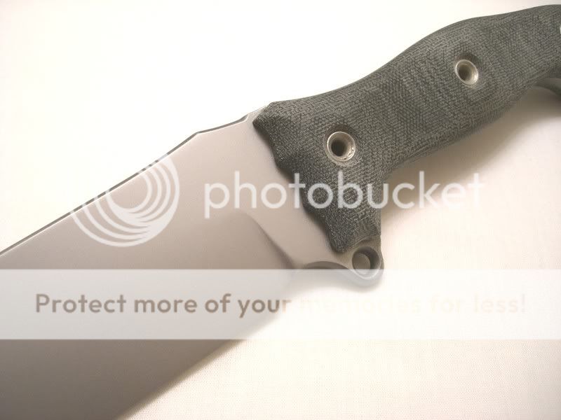

I've been working on all three of these for the last week and a half and finally finished them up. I've never been much on the coatings, though they're nice and serve a purpose. I prefer bare Infi. :thumbup:
All three of them got the DCBB treatment.
ETA: I owe a "Shout Out" to Solstice for answering a few questions I had about this procedure. :cool:
Before:
After:

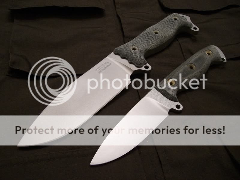

Comparison shot with ASH-1 Busse factory DCBB.
Thanks for the compliments!

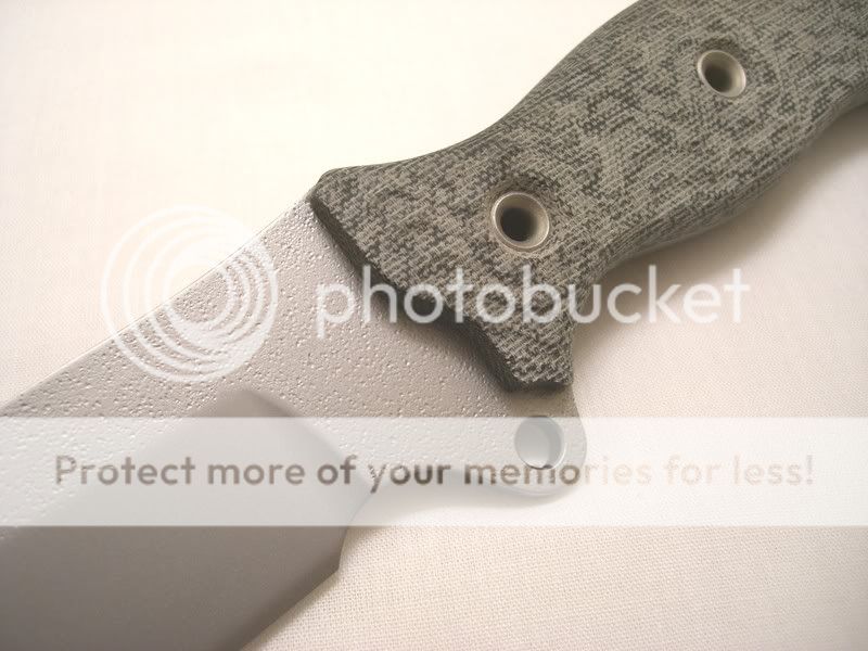

I left the slabs on. I like the idea of having the coating remain under the handles for protection.
I blasted the dimples with sand at 80 psi to get the coating out of them then the whole knife was blasted with fine grit glass bead at 65 psi.
