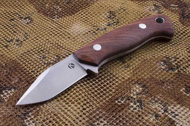

As for a custom (handmade) knife, great idea! Take a look at Dan Koster's page here, or www.kosterknives.com.
I was lucky enough to grab this one from him and I love it. It is his first prototype of this line, but he offers some great small fixed blades. You can read more about it here. If you are interested in skeletonized knives, the RAT Izula and Becker Necker are nice easy to carry knives. Check out the Makers section of the forum. Lots of great knives there.
IIRC, it was around $ 165, but it came with a custom hand made drop loop leather sheath and a kydex sheath. As I mentioned, they're still in development. He is up to v.4 now. I had v.2 and v.3 for a while for testing/feedback. There's a thread on his sub that talks about the passaround he is doing on v.2, 3 and 4. You can get good feedback from everyone that has tested them.
If you want something quicker, he makes a karda that he will put slabs on. Its a very nice knife. Also look at the RAT Izula and the Becker Necker. Both of these makers have subs here.
