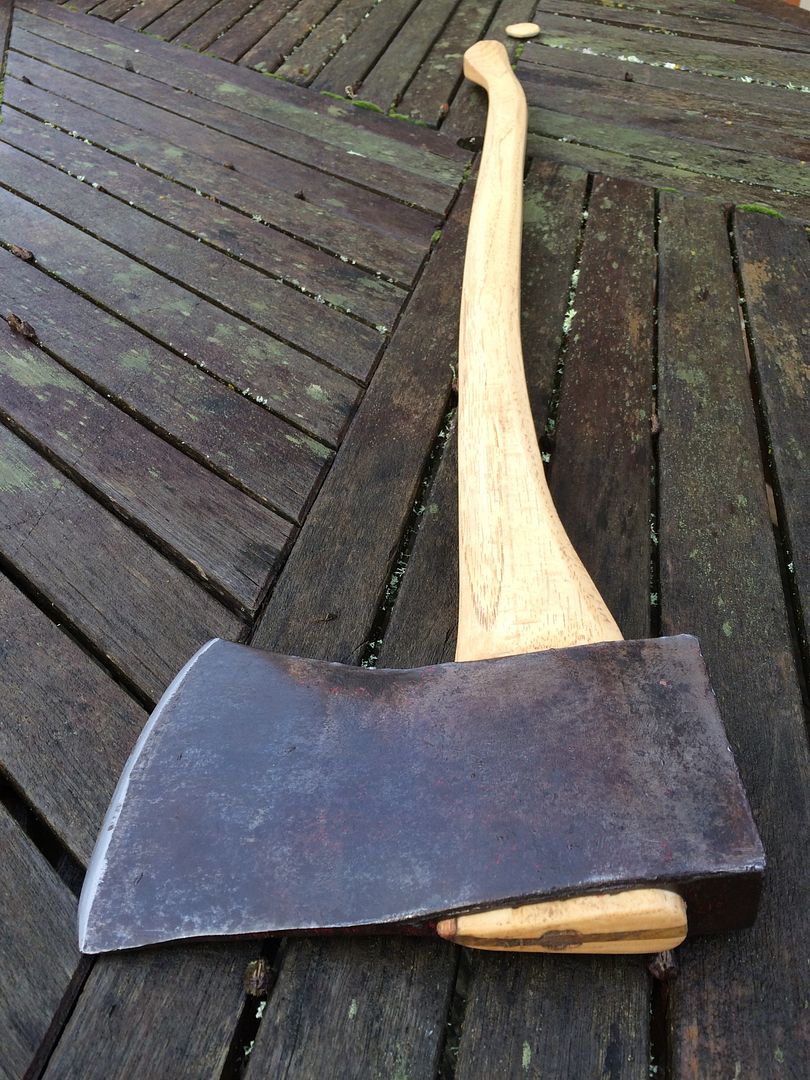

Maybe get one in both sizes? They take a good edge and make good users. There are no markings to claim provenance but the fir and maples here don’t seem to notice.
4lbs
2 1/2 lbs Boy’s axe
4lbs
2 1/2 lbs Boy’s axe
