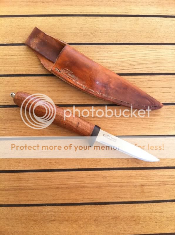

See if your local library has a copy of Bo Bergman's book "Knifemaking". Features various ways to deal with mora knife handles and includes lots of info on sheathes, too. Sells for well over $100 last time I looked.

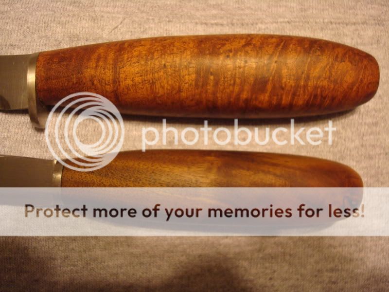

I bought some of the laminated steel Mora blades from TKS a long time ago as an experiment...and liked the result so much I started making a similar blade style in 154CM. Drill the center of your block tang deep with a bit just large enough for the tang to mostly fit down. You want it to be slightly tight. The guard will be a spacer later. Fit a guard in the normal way (instructions on this abound elsewhere). Use sandpaper or a Dremel style tool to notch the tang for better holding in the epoxy. You will basically fill the drilled hole with epoxy and slide the guard and tang in at one time. The epoxy will run everywhere but you'll grind it off when you shape the handle. You can even grind off the guard and leave just a cap if you like. Some examples:
Micarta works well for a guard too,
