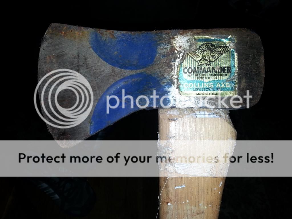

Look at the condition of this axe! Although the handle looked great, close to the head was wrapped in duct tape, so I was worried that it was damaged. But, for $3 I didn't care at all. However, when I removed the tape I saw that the original owner must have wrapped it for protection on the day he bought it. The wood looks factory fresh, AND the head is undamaged and tight. I don't really need a full sized axe, so it's already looking for a new home, but...

If your's is blessed with the 'flat slab' type (only 7/8" thick) handle that Garant markets in Canada (during the past 10-15 years) then this axe is not very old.

it looks like the typical Truper/Collins handles of the last decade or so, and still produced. very flat sided and not very nice to the hand(or eye). same handles that are available at Lowes and HD usually.
by the head itself, im sayin its not more than 20 years old. i bet the blue wedge is aluminum.

I wasn't suggesting that the steel was of poor quality (made in USA, it had better not be) but only that this was obviously a recent-made product. Those slab handles have hugely disappointed me ever since I came across the first batch of them on new axes (all Canadian Garants) and then found these same 'cheesehound' wood handles gracing the haft bins at the same store not long after. When manufacturers are willing to shave readily-visible material costs by 50% (traditional 1 1/2 inch thick hickory blanks down to 1 inch) then I suddenly become very very suspicious of what they've similarly done to the head metal specs. Could be s.e. Asia-pressed wrought iron/soup cans with a skiff of steel plating. Hickory standards will gradually turn into Oak and Ash, then Spruce and Fir, and ultimately become Poplar and Willow (and plastics) for all I know.

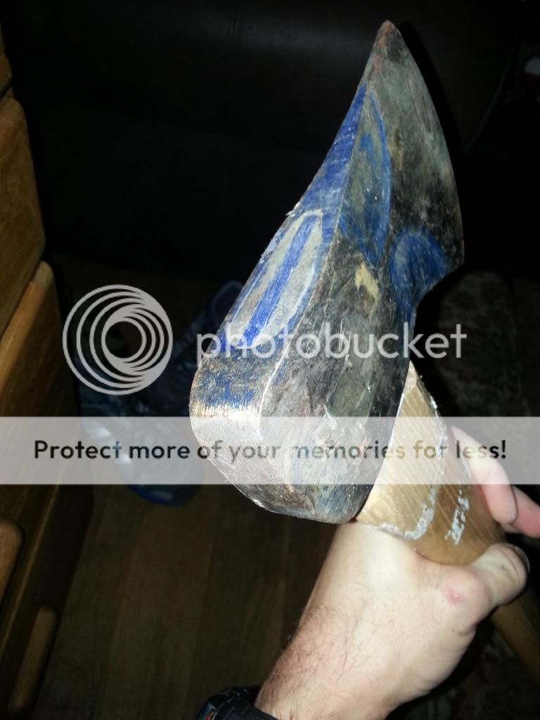

Confirmed, handle is just under an inch thick, and the wedge is aluminum. On one hand, I wish it was older. It certainly looks it based on the style of the head, I don't remember ever seeing anything like that in a store.
On the other hand, it IS a really nice new-condition older axe. I can't promise what the steel is, but the big fat sticker on the side of the head says Hand Forged, Made in USA. I have to believe that it is good steel.
