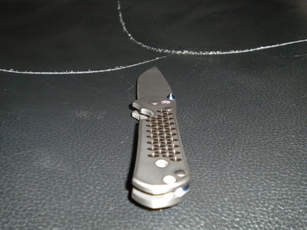

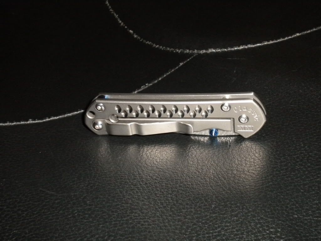

I decided it was time to do some work to my small classic sebenza. The handles were in need of refinishing, so I went to work with some scotch-brite. An hour or so later, I had a nice even satin finish.
I've always liked the plainness of a plain sebenza, but I decided I'd like to add a little bit of texture and flash to my knife. All and all, I'm very pleased with the results. I think it looks pretty sharp, there is definately more grip available while pulling it from the pocket, and nobody else has one exactly like it. :cool:
Please tell me what you think. Honest opinions only. Whether you like it or think I completely ruined the knife, let me know.
that is awesome! How did you get the ovals instead of circles? It looks great!
I used a ball end mill and instead of plunging it straight in like a drill, I arced it downward .030" for every .200" long cut.
I'm a machinist, if you couldn't guess already. Having a full disposal of some nice CNC machinery really helps with the side projects.:)
I was originally shooting for a "Gunner Gripesque" type pattern, but it's a little trickier than I thought to work around the existing holes in the scales and try and center everything. All in all I'm happy with how it turned out, but if I could do it over, I'd move the cuts on the lock bar side about .025" further away from the lock bar.

That is excellent work! I like it a lot better than some of the factory embellishments:thumbup:
Beautiful work! I'd be proud to carry a pattern like that myself.
About a .025" shift away from the lockbar, I think you did fine. Better a little close to the lock bar than too close to the edge.
I think it looks great!...never understood why we don't see a lot more decorated by the end user...lots of us have experience working with manual mills...why let Lisa have all the fun.
Now if you could anodize it to get a nice blue or something in there....:D
That looks pretty good to me, I might have been tempted to leave the lock side but it still looks good.
Maybe a bit of colour would be a nice touch to help finish that one off too :):thumbup:
Thanks for the kind words. Anodizing it passed through my thoughts, but I haven't found a color that you can anodize titanium that really strikes me. For the most part, they seem to be too "pastel" in color.
I do think a stone washing would look really nice and help it from showing wear however.
