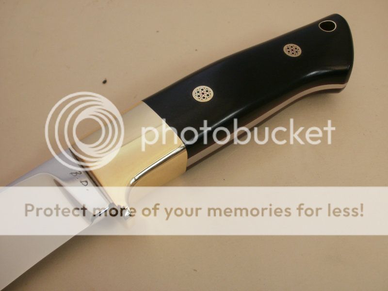

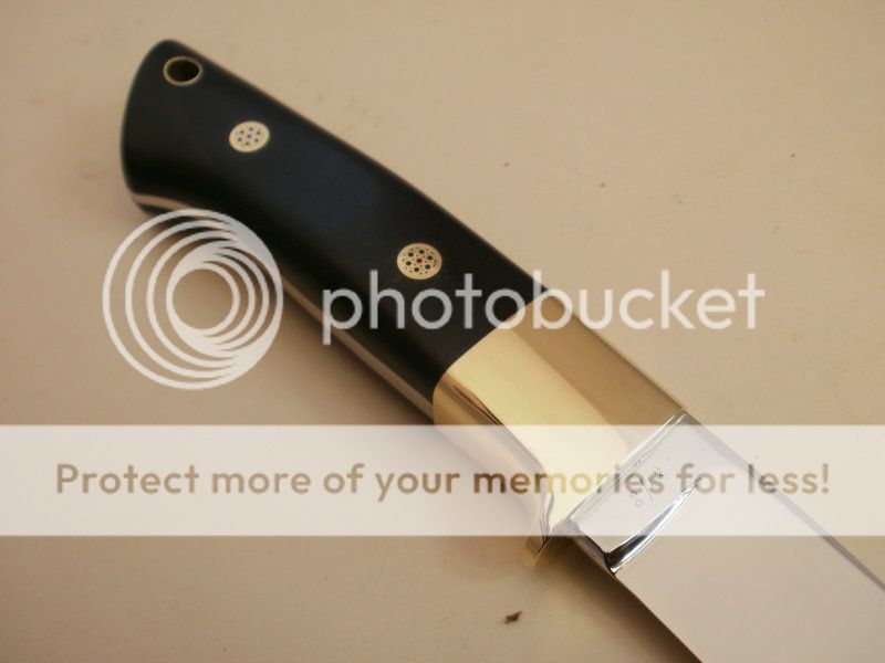

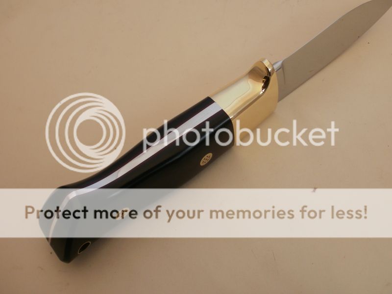

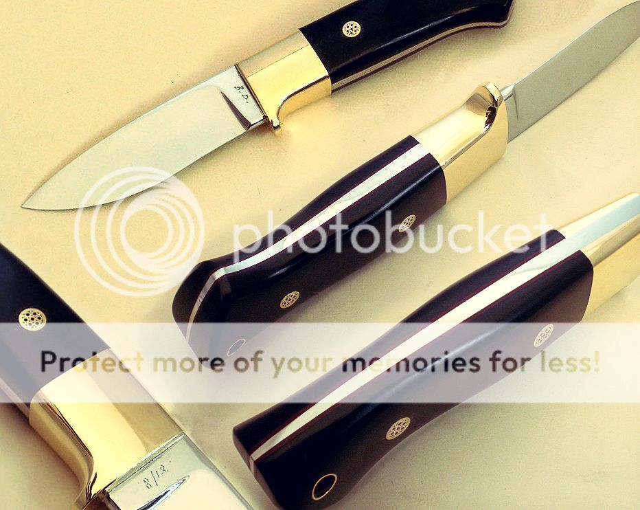

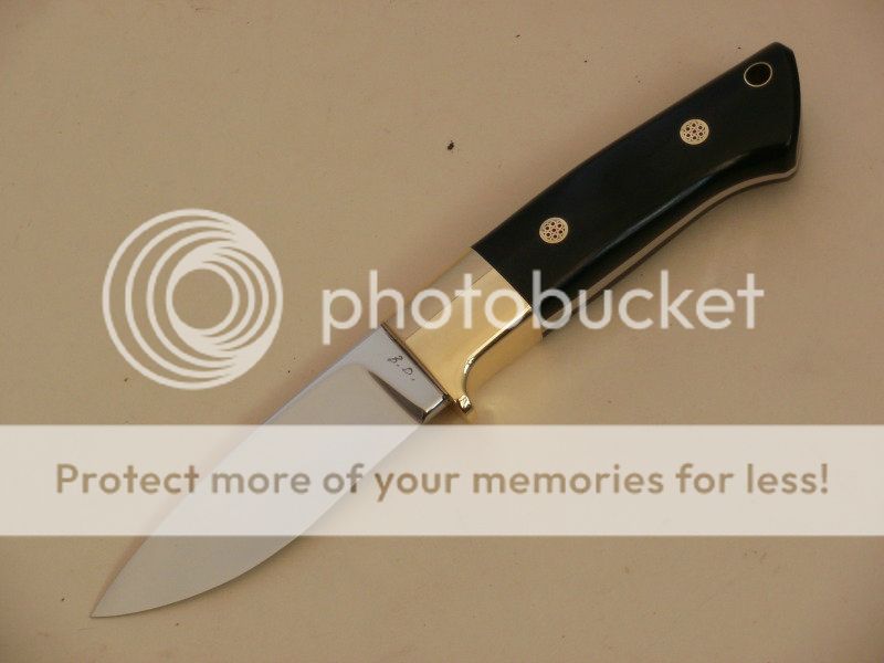

Hello all,
I would like to show you a drop point hunter that I have had the chance to experiment with.
As you can see I experimented with a longer guard and re-worked mosaic pins.
IR Bailey inspired Drop point Hunter
3 3/4" Hollow ground 01 Blade
Overall Length 8"
Phenol handle with red liners on a tapered tang.
fittings are brass and mosaic pins.
makers mark and date applied with a Burgess engraver.
As usual thanks for looking
