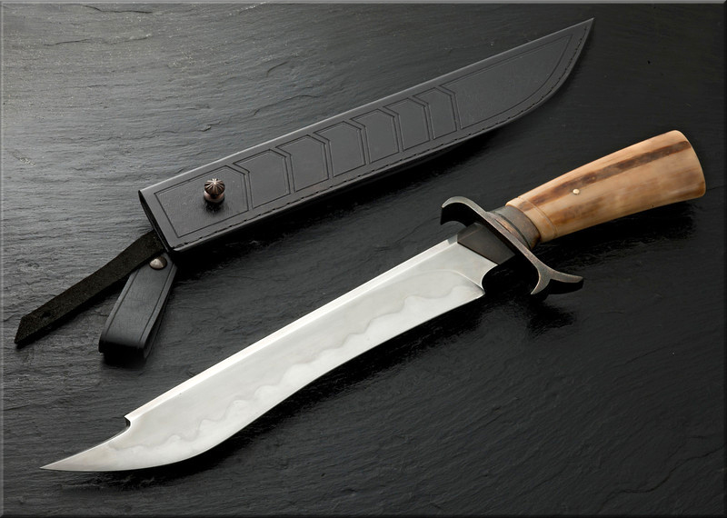

Great shots. Excellent use of lighting / positioning of subjects. Color and contrast look good without being overly boosted. Since you asked for criticism too, will offer a couple comments, please take them in the spirit they are given.
When your background has a large difference in brightness from your subject (bright blades on a black background like the GTC in the second pic and the bowie in the sixth shot) the scene can exceed the dynamic range of your camera making it a challenge to keep from blowing the highlights or erasing the shadow detail. Unless intentionally going for a high key or low key look, don't make it more difficult than it needs to be by using an overly dark or overly bright background. If going for a high key or low key look, set exposure for the subject and don't worry about the background.
My personal style is to add a small border or drop shadow to frame the shot. This makes it stand out more than unframed shots. A border makes it appear matted / framed, I generally bevel it a little for a slightly subdued border. In the interest of critique, took your Bowie shot into PS and adjusted the levels a little (histogram showed it a little underexposed) and put a small border around it. I feel centering photos in posts is more asthetically pleasing and recommend at least a little space between photos for separation, so they don't run together.

advice and critique well taken. I know Coop always has a border around his photos and knifemakers ID plus his sig.Been considering doing that as well. Thanks for all the comments and especially Mr. Jim Cooper's whom I hold in the highest of regards and respect.

Nicely explained, John, and well demonstrated too!
If I too may give an opinion with no offense meant, well, the shots taken with the
knives actually on a chosen background do look good, but those (especially the engraved
bowie composite on the blue cloth) look strange. The knives should be "anchored" to the
background by throwing their shadow upon it. In that picture they seem floating in the air.
You can either use the "shadow option" in Ps, or, for a better and more controlled
natural look, create each shadow on a separate layer filling the "feathered" outline
of the knife with black and controlling its "Opacity %" and choosing its "Multiply" option
to blend in with the background colors...
All the best,
David Darom (ddd)

David: There are some shadows in the engraved Bowies, which have me more interested in how it was accomplished, than trying to correct them. LOL!
John: Editing preferences noted. I like a border too, but that one is still too subtle for me. Better than original.

David: Critique appreciated. I actually did shoot the bowie on the blue frabic. I was playing around, you are right, they should be anchored.
The Lozier dagger, like the bowie just mentioned, also defies gravity. The Strider is my only true composited photo in the batch.
