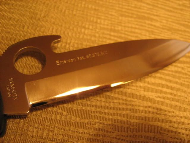

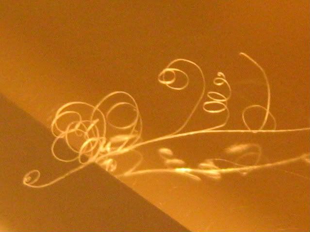

My endura was on the chopping block among other things but after some recent TLC some really good pic's and one of IMO best convex reworks I've done I don't think I can let her go. Just wanted to share some pic's, enjoy.

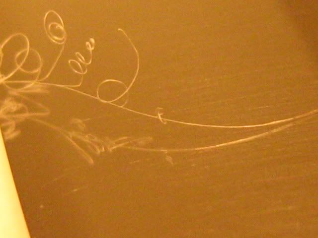

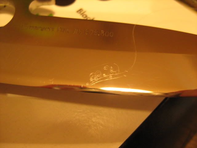

Some really small curls of hair too :D
The first picture makes it look a little better than it is, there's still some factory marks to work out.
Knifenut, which would you say is an indication of a sharper knife? thin curls or a hair split approximately in half? Great looking bevels, BTW. You have crazy skills. :D
It was already thinner hair than normal so making the cuts was even harder. Indication?? the number of thin curls able to be taken from the same spot, as you notice the length of the curl and how they overlap. With each cut the hair becomes thinner and each cut harder, only a sharper knife can do better :)
Thanks everyone, the second pic is one of the best edge shots I have ever taken IMO. The way it shows the the seamless flow from main grind to edge and the detail in which the camera captured the cutting edge is amazing to me.

Honestly, can you explain how you went about sharpening that?
I've never had a knife even remotely that sharp. I can get my knives factory sharp, but nowhere near that.
-Freq
-Freq
I started with 400 grit and progressed to 2000 grit on a EMS sharpening block I then polished with a zig zag wrist rolling technique on balsa wood progressing from 6 micron to 0.5 micron diamond compound with a final angle around 20 degrees per side.
