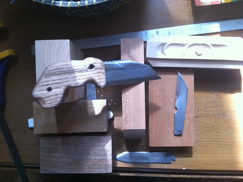

Here's a pic of some of the wood I picked up and a couple of knives and blades in progress
Untitled by rlibson, on Flickr

This was just me digging through his "burn" wood in the garage....wish I could have made it to his real shop.

And as an aside, wood that is wonderful for furniture would in many cases be FAR less wonderful as a knife handle. The image you posted seems to show a handle that has grain that is far too large for use as a knife handle. The pieces behind it may be better... I can't really tell.
Sorry to rain on the parade.
don't worry about raining on my parade I've got plenty of umbrellas.
Yeah that knife is more a shiv than anyting..it's the leftover piece of a broken draw knife that I hacksaw'd in half and handled in some scrap oak flooring. No bolsters, no guard, the pin holes aren't square and it's epoxied with essentially goop..it's a wreck but it was fun.
Only real piece of wood that I would use for a handle on it's own was that bubinga...not sure if it's the right kind of wood but it seems pretty dense and tight grain. The will probably be glued together to create some accents/inlays down the line.
