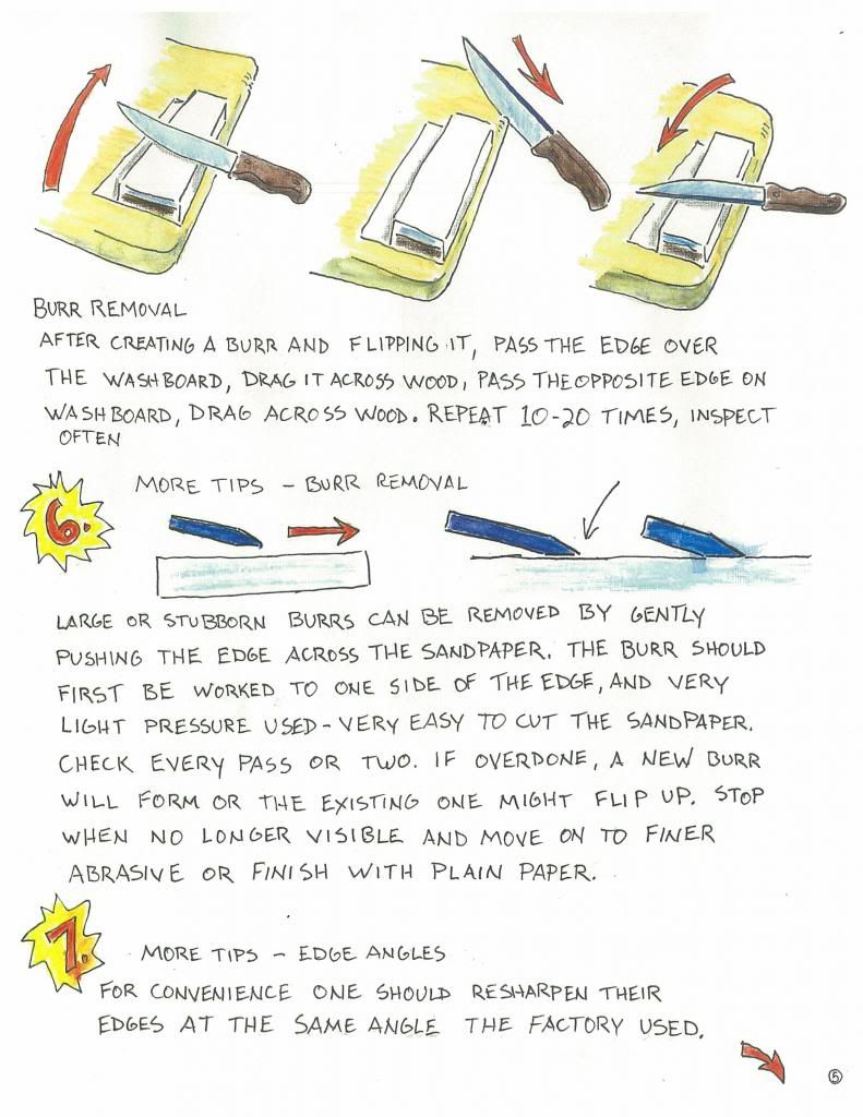

Using your current method you could try "brushing" off the burr. Use real soft edge leading passes across the paper on the burr side, just enough to contact the slack of the paper without really pushing it down into the lower layers. You can also do an accelerated version of dragging the edge across endgrain wood. Are you using a leading, trailing, or scrubbing pass?
For speed sake, I'll sometimes just give a light drag across wood once I feel a burr forming and have flipped it once. Drag across wood, make a pass, drag across wood, make a pass on the opposite side, repeat 10-15 times and check. If clean, lightly finish with a few very light trailing passes and move on to the strop if desired.

Martin, on the sandpaper, I do most of the work with trailing passes. I minimize the burr with light trailing passes then switch to EXTREMELY light edge leading passes. It was almost required on this knife. (An GEC Hayin' Helper in 01. O1 is good stuff. This is my second GEC in O1.) I don't understand what you mean by drag the edge across end grain. The end grain is the grain in a cross sectional cut IIRC. Is that drag a stropping motion or are you cutting into the wood like Murray Carter?

You can use end grain or just drag it across he wood at any grain direction. Endgrain seems to work best but I've used either/or. Instructions are for WB but this works on any trailing motion. Also some instructions for using the slack with a leading pass. Both these methods work very well once you get the hang of it.
