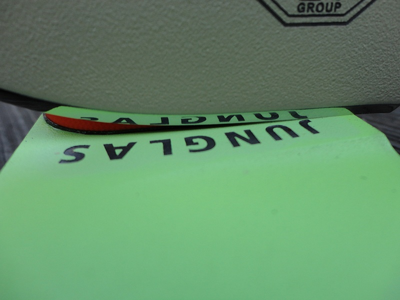

I freehand all my stuff on DMT stones and finish with black compounded strops.
ooooh pictures! I freehand also, with chosera stones and green paste on a strop.
