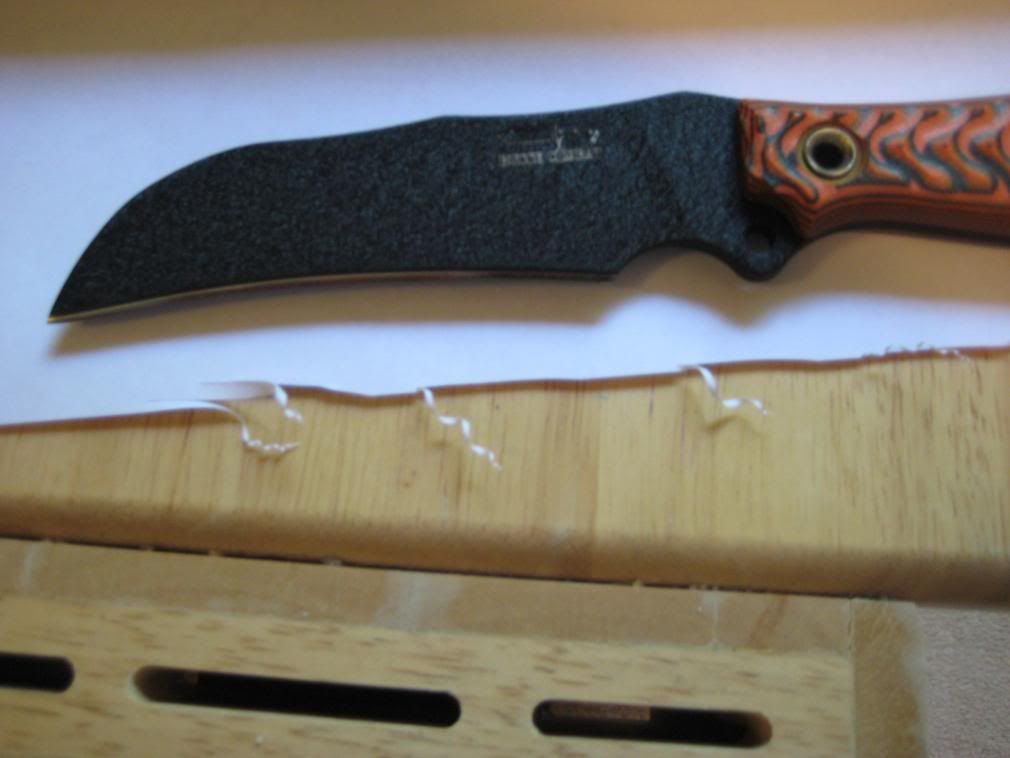

I made a strop bat.
I had a brand new leather belt (high quality, heavy leather belt).
I stepped on the buckle in the dark in my bare feet. It broke and really hurt my foot!
I use green buffing compound (red top container #6) from the hard ware store. Works to keep my knives hair popping sharp.

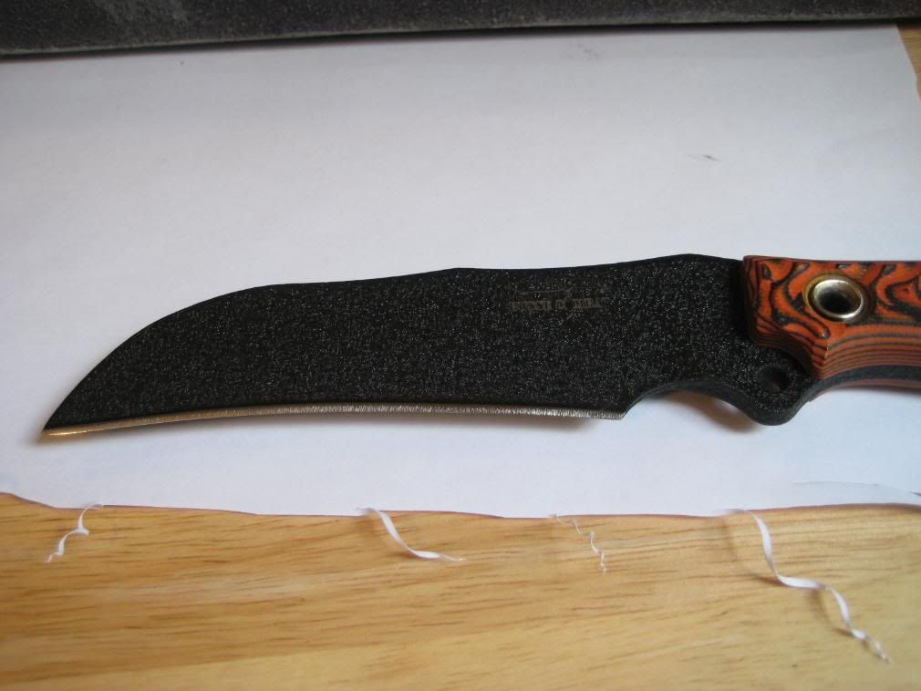

the crappy 4 sided strop I made (carved with the SS)
those curls were cut after a few minutes of stropping (it got much shinier and sharper over the next few times)
There are better cutting compounds out there, but I can tell you that my knives are sharp with just these.
I only use the Red (#6 green buffing compound).
