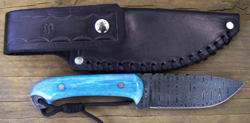

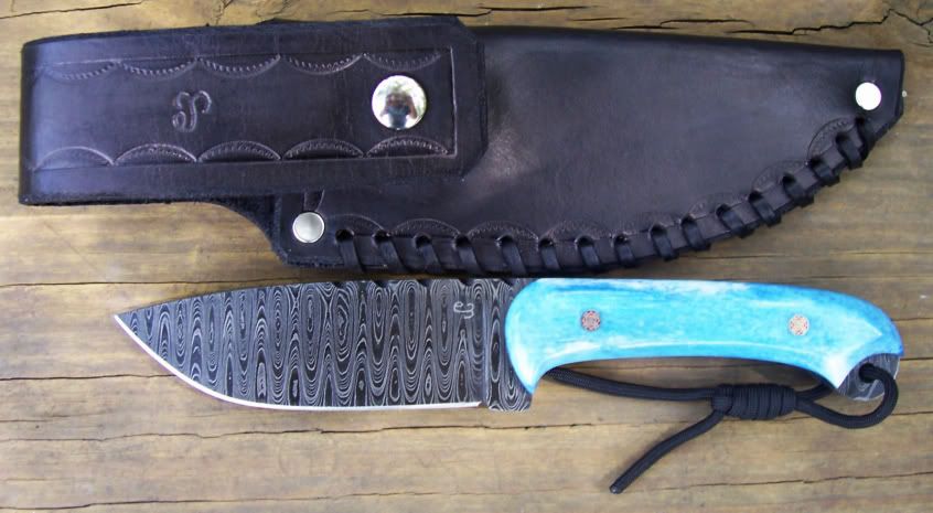

So I did this
Actualy it's for a customer, he has two others in this pattern,different sizes and damascus patterns.Now he get's a third.
Steel is 152 layers of O-1/1095/L6/15n20
Blade is 4.375" and 9.625" overall, flat grind from .187" stock.
Scales are dyed camel bone with mosaic pin and black liners.
Please forgive the pic's
Thank you
