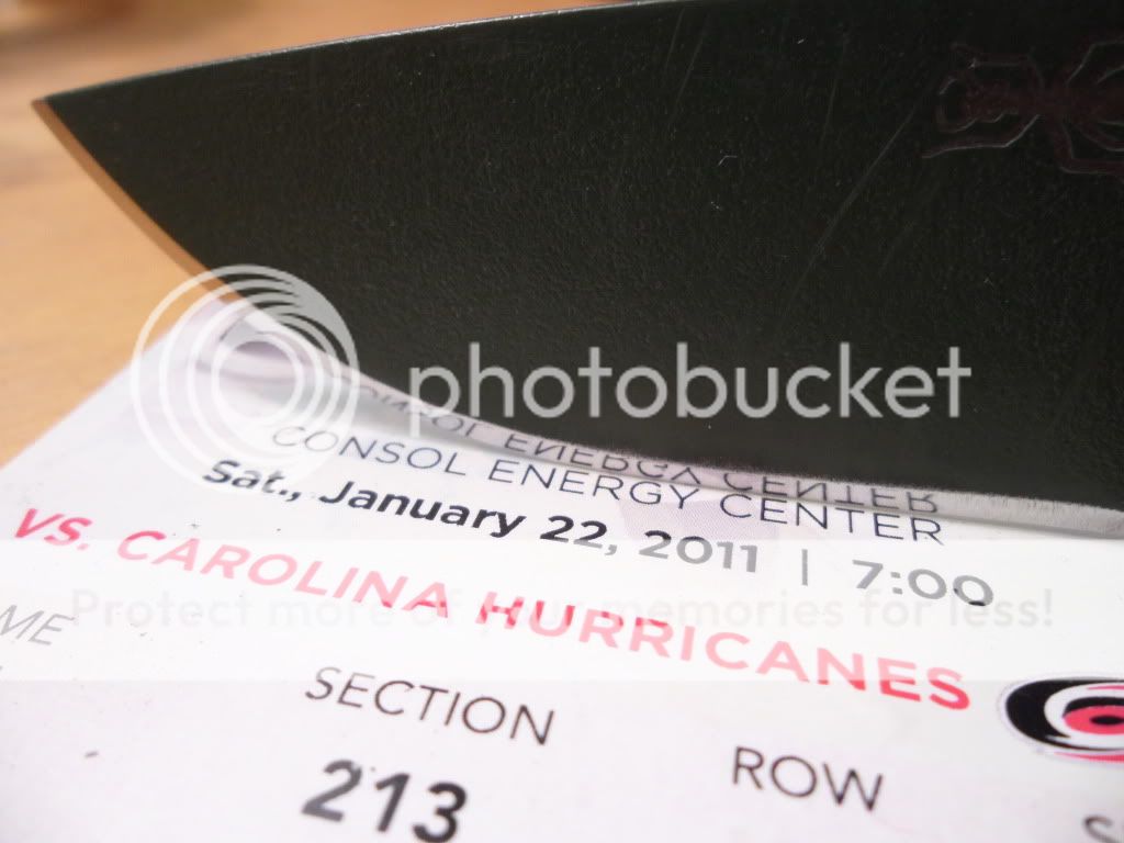

So I decided to try my hand at convexing and polishing the edge of my Izzy. It turned out pretty well and is super sharp. It's not a super defined convex, but not a traditional V grind by any means.
Very nice! I wish I could do that. What did you use to get the edge like that?
In my wildest dreams, my edge would look like that. Share some tips.

I used successive grits from 600 to 3200 of wet/dry sand paper on a mouse pad. When I was at the 3200 grit, it had a pretty decent polish, but I finished it up on a piece of cardboard loaded with some Metall racing polish. It took me all of about 15 mins from start to finish.
beautiful
so progressive as in say every 400?
thanks for any help man looks amazing
