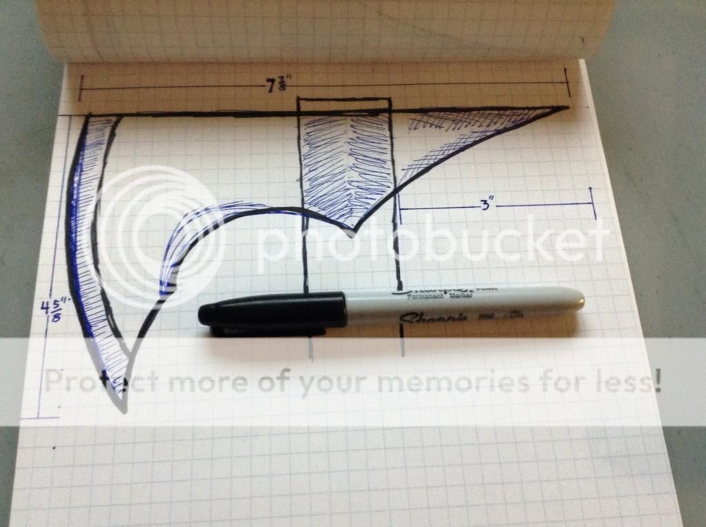

I can't sleep for some reason so I started doodling and this is what I came up with.
I'm fully aware it would be heavy and the beard is more fantasy than anything els but the more I look at this the more I want to get it forged out. I may have to do just that once the holidays are over and I have money again.
Any thoughts? Good or bad I'm all ears.
If the beard was shortened about 3/4 of a inch it would be much more functional while still looking like total badness!
If I do I will the problem is I just found out Steve Liley (might have spelled that wrong) retiered so now I'm not sure who to talk to to get it forged. Any suggestions?
If you made the eye an inch deeper it would have a much more solid connection between the haft and the head.
My thoughts also. But I'd add much more than 1". Check out a regular double bit ax. The eye is 3-4" deep. This allows the wood to take the torsional forces of thousands of strikes without breaking. The wood at the top of the rear of the haft, on your design would be prone to denting and breaking with strikes to the lower half of the edge. During a prolonged battle there would be a greater chance of loosing the head (of both the ax and the wielder).

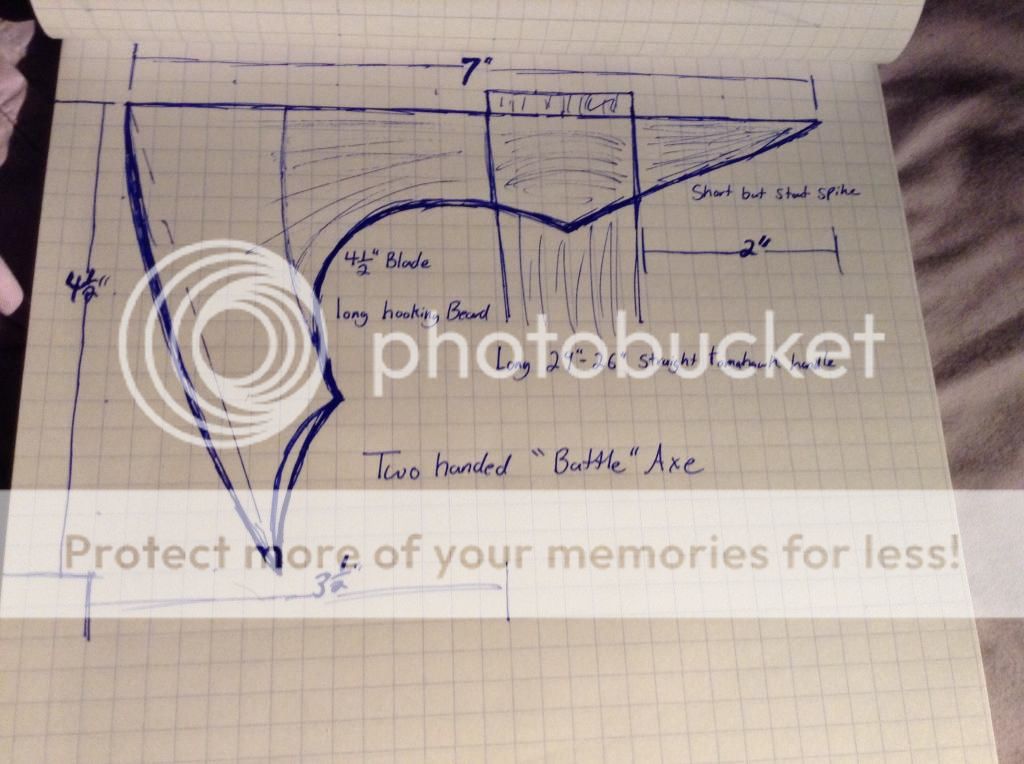

I re drew it a little larger, with some more meat behind the beard and with about an inch added to the eye. I didn't want to add much more because of the weight and I'd really like to use tomahawk handles with this thing. Oh and it's drawn to actual size the sharpie is there for scale.
The heel will not hold up to anything. You have to support that heel a little.
If the battle axe needs a hook for ripping make it in the poll.
I've thought about taking a cheap no-name broadaxe (with a 10+" bit) and cutting it in half perpendicular to the eye and trimming them down to a matched pair of bearded fighting axes similar to that.
I agree with Garry... love the profile but the shallow heel will lead to broken handles time and again if used hard.
Making the throat of the eye more of a symetrical "M" shaped will cure this and not alter the aesthetic much.

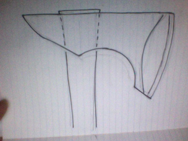

A better way to say it is actually probably symmetrical "v" ... like in your first drawing. .. where the front and back of the throat cross the haft at the same level so as not to induce asymmetrical tortion pressures on the haft.
... if that makes any sense.
Oooh ok I get it I'll re draw it when I have a minute I'm stoked about all the help you guys are offering thanks!
