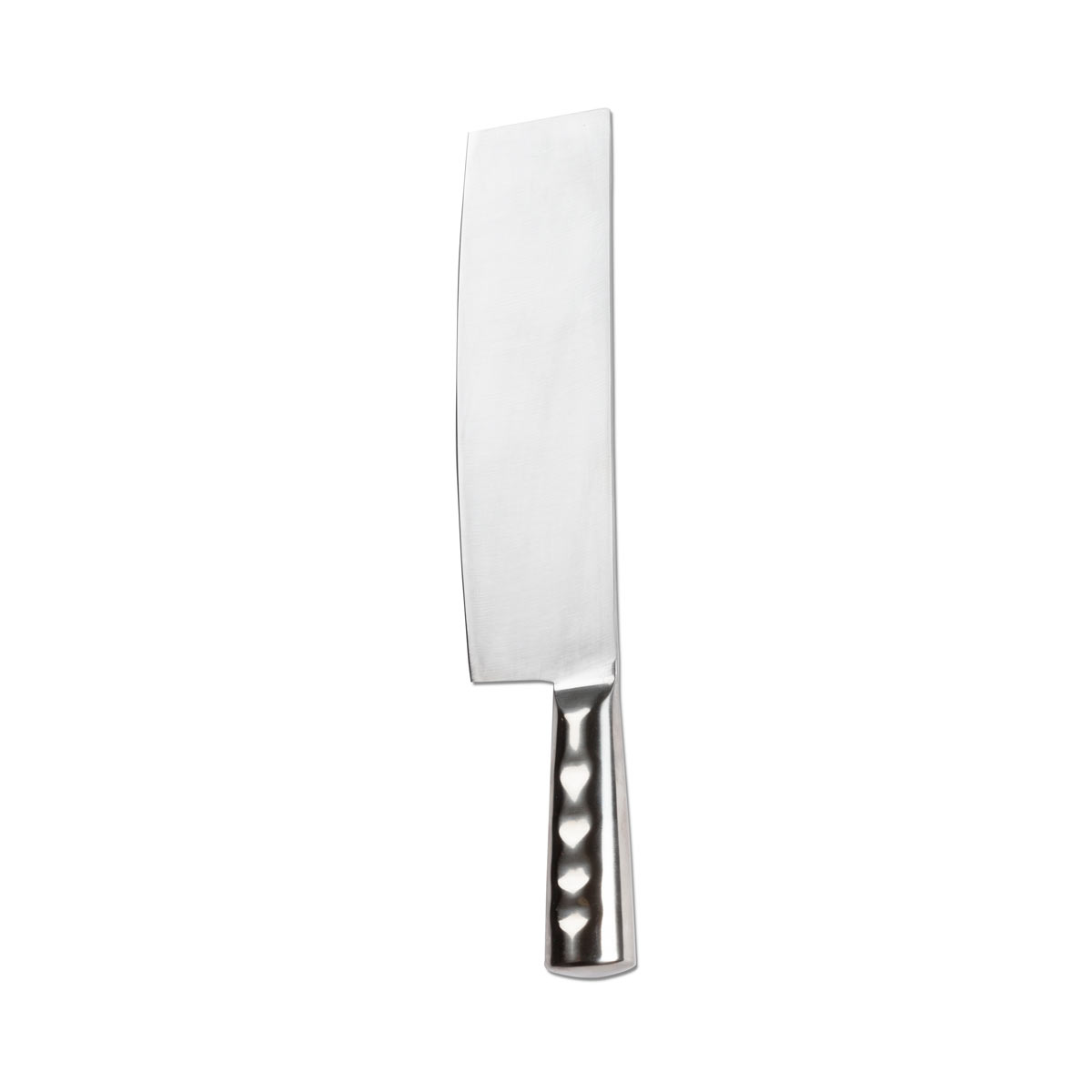

Knowing what we now know about the billet maybe a cleaver would be your best bet.
BINGO! … Horsewright has a great solution. Make a "Chinese Cleaver" shape form it. Do a FFG to a .005" edge, convex that to the final edge, and it will dice and chop.
something shaped like this:
